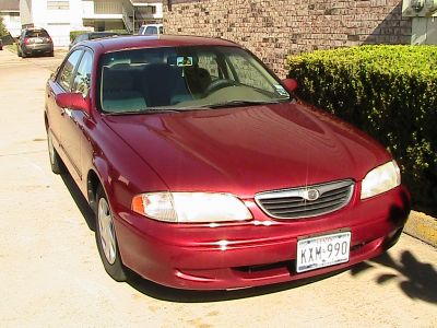

my alternador is pushing out the right voltage and my bettery is taking in the right voltage but my battery is going dead while im driving.. what is the problem[img:9582ae14ff]http://www.2carpros.com/forum/automotive_pictures/323946_img0137vd8_1.jpg[/img:9582ae14ff]
