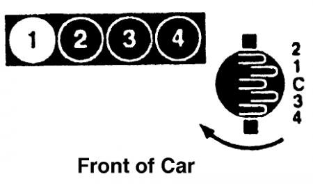

I took off plug wires off and got them mixed up.
I need to reinstall them properly, Help.
Oct 25, 2010 at 3:29 AM
Experienced Mechanic
75,988 POSTS
Firing Order: 1 - 3 - 4 - 2
