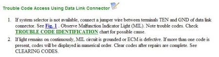

how to check codes at home with out going to repair shop. engine light stays on all the time.
when you crank car for first time and let run until temp gets to half way . then engine shuts off and wont crank until engine is completeey cold.

Hi there, Extract flash codes as per instructions, report codes here for more assistance if required. Mark (mhpautos)
https://images.2carpros.com/forum/automotive_pictures/61395_1_91.jpg
