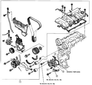

Service and Repair Fig. 19 Water Pump Removal
https://images.2carpros.com/forum/automotive_pictures/12900_w_6.jpg
Deactivate audio anti-theft function as outlined under Technician Safety Information , before disconnecting battery. Remove timing belt. Remove water pump assembly and rubber seal, Fig. 19 . Reverse procedure to install. Tighten bolts to specifications. Reactivate audio anti-theft function as outlined under Technician Safety Information. https://www.2carpros.com/kpages/auto_repair_manuals_alldata.htm
