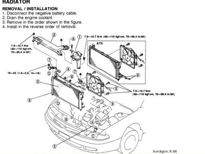

We need instructions for replacing the radiator on this vehicle.

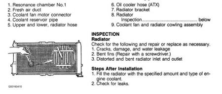

Dec 6, 2009 at 10:26 AM
