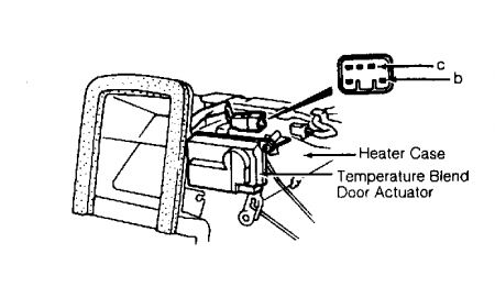

Would love some suggestions of what to look at - all the AirCon switching on the Mazda 626 do not change the direction of the airflow to the windshield. And a potential seperate but significant problem is that the air is always hot - when moving to the cool on the thermo it is still stuck on very hot. I have the service manual - could you quickly outline for me what I should check? Also - how can I access the air conditioning system do i need to disassemble the entire inside dash of the car down to the firewall? what is the best way to access it?

Sounds like your control doors are not functioning correctly .. you will need to remove the dashboard i'm afraid to check these .. let me know if you need any of the diagrams listed below ?

Temperature Blend
Remove instrument panel. See INSTRUMENT PANEL under REMOVAL & INSTALLATION. Disconnect actuator connector. See Fig. 6 . Apply battery voltage across actuator connector terminals "c" and "b".
Actuator should move door. Reverse battery leads. Actuator should move door in opposite direction. Replace actuator if door does not move as specified.

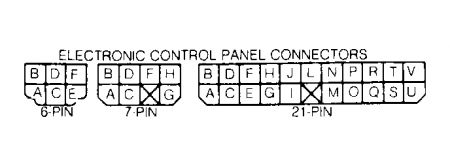

- yes would love to see the diagrams on the actuator - just to confirm the wiring harness to test is actually behind the dashboard ( the actual gauges? ) - i was thinking maybe I can test from the main harness in the back of the ac computer which is easy to access - you wouldn't have the pinout for the connection on the back would you? Thanks a lot!
Jan 3, 2009 at 3:27 AM
MANDRAS
... its actually a Ford Telstar 1992 - which is identical to the Mazda 626 - but the dash is slightly different. I am worried the pinout might be difference for the AC control module- not sure if you have any advice on this as I think the Telstar is not sold in the states.
Jan 3, 2009 at 4:18 AM
DAVE H
  • 13,384 POSTS
I don't have a diagram for the telstar ... you will have to look and see if the are the same .. ?? chances are if the connectors are the same the wiring is the same ? if you do voltage and ground test's and the pins are the same then I would guess the rest are the same ? Airflow Mode Control Circuit Remove control panel. See CONTROL PANEL under REMOVAL & INSTALLATION. On back of control panel, connect battery positive lead to terminal "D" of 7-pin connector and negative lead to terminal "L" of 21-pin connector. See Fig. 7 . Leave battery connected to these terminals during testing procedures. Connect jumper wire between terminals "I" and "L" of 21-pin connector. Connect a resistance of at least 1000 ohms between terminals "D" and "L" of 21-pin connector. Check voltage between terminals "D" and "L" of 21-pin connector. If about 12 volts is present, go to next step. If about 12 volts is NOT present, replace control panel. Disconnect resistance and jumper wire connected in step 2). Connect a jumper wire between terminals "C" and "L" of 21-pin connector. Connect a resistance of at least 1000 ohms between terminals "A" and "L" of 21-pin connector. Check voltage between terminals "A" and "L" of 21-pin connector. If about 12 volts is present, go to next step. If about 12 volts is NOT present, replace control panel. Disconnect resistance and jumper wire connected in step 3). Connect a resistance of at least 1000 ohms between terminal "D" of 7-pin connector and terminal "D" of 21-pin connector. Check voltage between terminals "D" and "L" of 21-pin connector. If less than one volt is present, go to next step. If more than one volt is present, replace control panel. Disconnect resistance connected in step 4). Connect a resistance of at least 1000 ohms between terminal "D" of 7-pin connector and terminal "A" of 21-pin connector. Check voltage between terminals "A" and "L" of 21-pin connector. If less than one volt is present, go to next step. If more than one volt is present, replace control panel. Disconnect resistance connected in step 5). As specified in AIRFLOW MODE CONTINUITY TEST table, select airflow mode and check continuity between indicated terminals of 21-pin connector. If there is no continuity between indicated terminals, replace control panel. If continuity is as indicated, airflow mode control circuit is okay. AIRFLOW MODE CONTINUITY TEST Mode Button...........Continuity Between Terminals VENT..........................................J & L BI-LEVEL.....................................G & L HEAT.........................................H & L HEAT-DEFROST...........................E & L DEFROST....................................F & L
