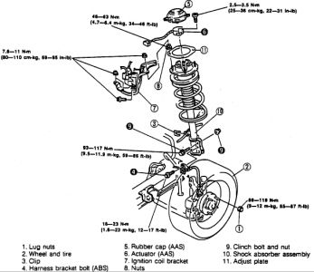

Is it difficult to replace the front struts on a 1990 mazda 626?
Saturday, June 26th, 2010 AT 10:34 PM
MECHANIC
75,992 POSTS
It doesn't require a genius just follow the repair manual just make sure you have a spring compressor if you're replacing the shock absorber
