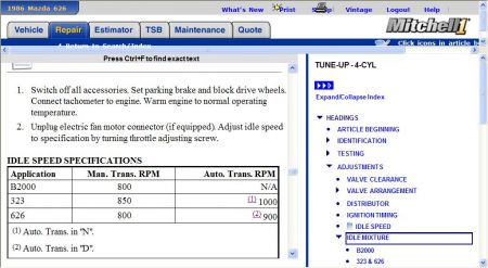

how do I adjust the idle in an 86 mazda 626

See below
https://images.2carpros.com/forum/automotive_pictures/12900_idle_speed_3.jpg
