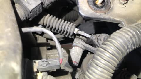

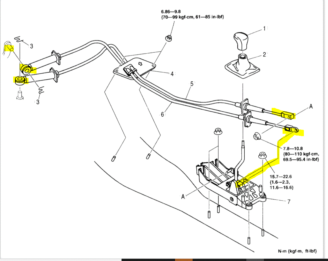

The idea that the shifter moves all over without actually shifting leads me to believe the linkage has come apart. There are two cables between the shifter in the vehicle and the transmission. I attached a picture below to give you an idea of what I'm referring to.
Here is what I want you to do. Have a helper move the shifter around in the vehicle while you watch at the transmission to see if there is any movement in the cables. Also, make sure nothing has come disconnected (which I am suspecting at this point).
If you open the hood, you will see the cables on the transmission. Let me know what you find. Also, let me know if anyone has checked the transmission fluid level. If it is low or very dirty, it can cause a hard shift which may have led to a linkage issue.

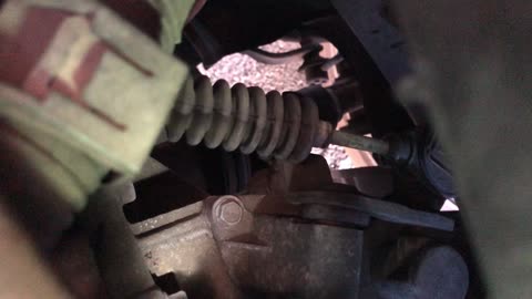

Sorry for the delay. I haven't had time to work on the car until today. However, I took a short video of the result showing the gear cables moving around when someone moves the stick in the neutral position. That is all I can get the stick to do at this point.
Does this give you a better idea of the problem and what it might take to fix? I am not thinking I would be the one to fix it, but would like to know, generally, whether or not this would be expensive or not. Thanks.

  • 110,240 POSTS
There are two cables. I have a feeling the other one is the issue. Are you able to remove the console to inspect the cable and where it's attached? That will tell us if that is the issue.
When the linkage is moving, there appears to be play in the bushing which may have been causing what you experienced prior. Are you able to try and move the shift lever by hand? Also, do you see the other shift cable?

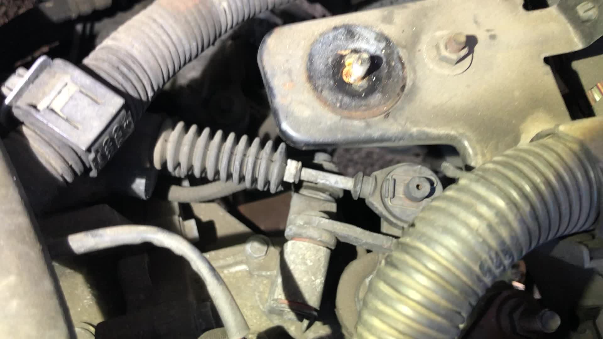

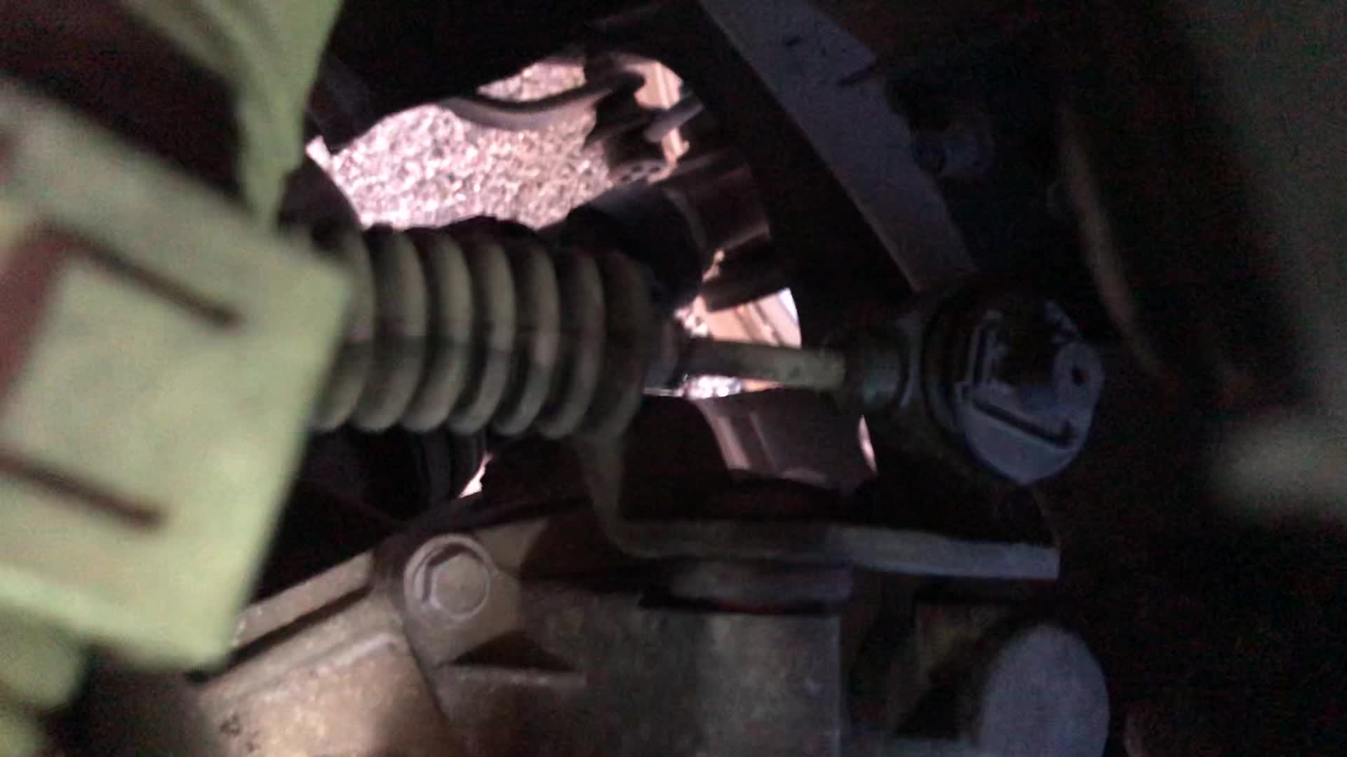

Hi Joe.
I think my earlier submission didn't go through so sending it here again.
I am leery of trying to remove the console, as I have no idea how to do so and I am unsure how much more time I can spend on this issue. Separately, what are the bushings you mention?
I took some more video of the shifter cables moving when someone tries to shift, and I am hoping this video is more useful to you. What I am hoping to get is enough information that I can use when I call a mechanic for a rough estimation of what it would cost to fix this problem. Fingers crossed! Thanks.

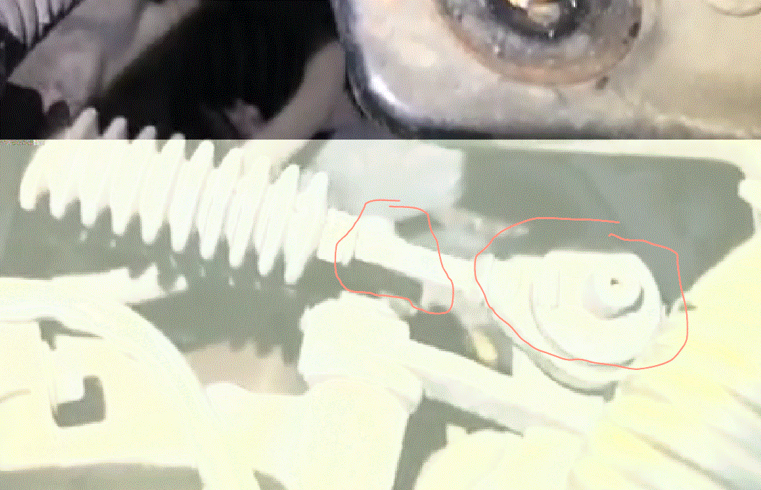

  • 110,240 POSTS
I copied a pic from your video and circled two places where the linkage attaches, and the bushings would be. If you watch the video, you'll notice play in the connection before it starts to move the linkage. If that same play is in the opposite end, there is a chance the cable can't move the shift levers far enough.
So, first, tell a shop you need the shift linkage and bushings at the shifter checked. Also, ask what it would cost for all to be replaced. Meaning, he would replace both inside and under the hood bushings.
I'm seeing excessive play under the hood. If you want to try and remove the console, let me know and I'll try to help from here.
Let me know what I can do to help and what you find out.
See pic below. Note: The red circle in the center is for the linkage under the upper cable. You can't see it too well in the pic.
