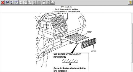

06 mazda 6 ,i cannot locate the cabin air filter to change it, fell silly going to the shop for a cabin air filter change ,any help is greatly appreciated.

Remove glove compartment. Check out the diagrams (Below). Please let us know if you need anything else to get the problem fixed.
https://images.2carpros.com/forum/automotive_pictures/12900_cabin_filter_7.jpg
