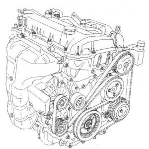

2005 Mazda 6 4 cyl Front Wheel Drive
Anyone know the diagram for the serpentine belt
Jan 30, 2010 at 5:20 PM
  • 75,992 POSTS
2005 Mazda 6 L4-2.3L
https://images.2carpros.com/forum/automotive_pictures/12900_db_1.jpg
DRIVE BELT REPLACEMENT 1.Remove the splash shield (RH).
https://images.2carpros.com/forum/automotive_pictures/12900_db1_1.gif
2.Turn the center of the tensioner pulley clockwise to release tension to the drive belt. 3.Remove the drive belt. 4.Reinstall the drive belt or install a new drive belt. 5.Verify that the drive belt auto tensioner indicator mark does not exceed the limit. **If it exceeds the limit, replace the drive belt. 6.Install the splash shield (RH).
