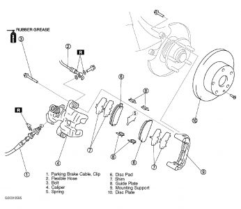

after removing the rear calipar, calipar bracket and two screws holding on the rotar. How do you remove the rear rotors from this point.
I've tried hitting the rotar with a small 2 pound hammer with no luck.
Thanks
Paul

A little lubrication and a bigger hammer !! REAR BRAKE ROTOR Removal & Installation Raise and support vehicle. Remove rear wheel assemblies. Remove components in the order indicated in the illustration. See Fig. 16 . Machine rotor if lateral runout exceeds specification. Replace rotor if measured thickness is less than specified minimum thickness. See DISC BRAKE SPECIFICATIONS . To install, reverse removal procedure. For disc pad installation see, REAR DISC BRAKE PADS . Tighten all fasteners to specification. See TORQUE SPECIFICATIONS . After installation, depress the pedal several times, rotate the wheel by hand, and verify that the, brake does not drag.
https://images.2carpros.com/forum/automotive_pictures/266999_brake_11.jpg
