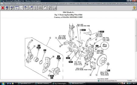

how do I remove the front hubs and bearings thay seem to not want to come out? I just want to change my front bearings is that so wrong.
Jan 7, 2009 at 6:34 AM
DAVE H
  • 13,383 POSTS
WHEEL HUB & STEERING KNUCKLE REMOVAL/INSTALLATION CAUTION:Performing the following procedures without first removing the ABS wheel-speed sensor may possibly cause an open circuit in the harness if it is pulled by mistake. Before performing the following procedures, remove the ABS wheel-speed sensor (axle side) and fix it to an appropriate place where the sensor will not be pulled by mistake while the vehicle is being serviced. Remove in the order indicated in the illustration. Install in the reverse order of removal. After installation, inspect the front wheel alignment. (See WHEEL ALIGNMENT .) Fig. 5: Removing/Installing Wheel Hub & Steering Knuckle
https://images.2carpros.com/forum/automotive_pictures/266999_hub_7.jpg

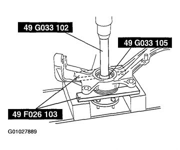

Wheel Hub Component Removal Note Remove the wheel hub component using the SSTs. Fig. 7: Removing Wheel Hub Component Using Service Tool Courtesy of MAZDA MOTORS CORP. If the bearing inner race remains on the front wheel hub component, grind a section of the bearing inner race until approx. 0.5 mm {0.02 in} remains. Then remove it using a chisel.
https://images.2carpros.com/forum/automotive_pictures/266999_hub_8.jpg
