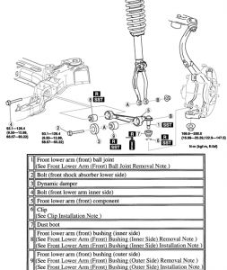

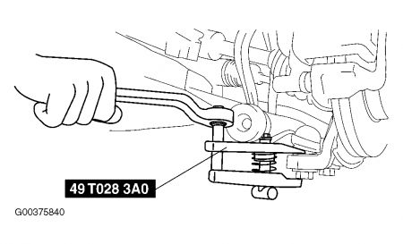

Instructions for changing the lower ball joints
May 7, 2010 at 4:14 PM
BLUELIGHTNIN6
  • 16,542 POSTS
https://images.2carpros.com/forum/automotive_pictures/261618_Noname_2128.jpg
https://images.2carpros.com/forum/automotive_pictures/261618_Graphic_493.jpg
