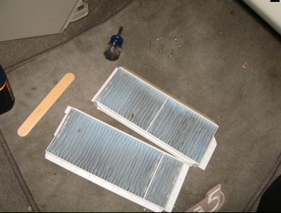

I need to find out how to change the cabin air filter for my vehicle. Thanks.

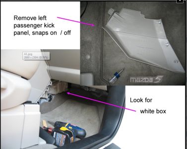

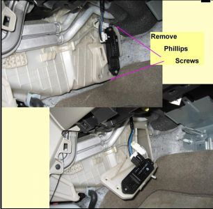

What does the undercover look like and where is it located and what does the MOS FET connector and evaporator temperature sensor connector look like/

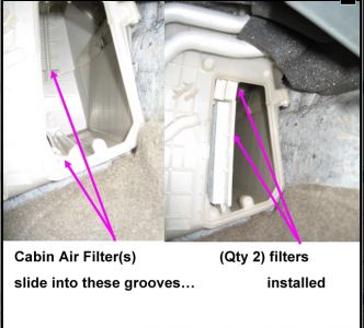

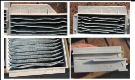

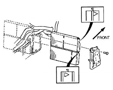

It is a decorative piece no one can see unless your working under the dash / below the glovebox. It just snaps on / off. The MOS FET connector is just an electircal pigtail connector and is only equipped on the automatic a/c style. Pics below should help you ..
