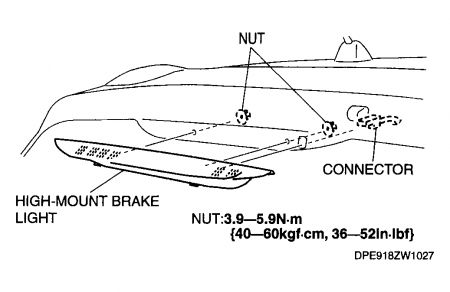

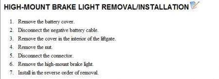

how do i replace the 3rd brake light assembly?

https://images.2carpros.com/forum/automotive_pictures/261618_Noname_1908.jpg
https://images.2carpros.com/forum/automotive_pictures/261618_Graphic_407.jpg
