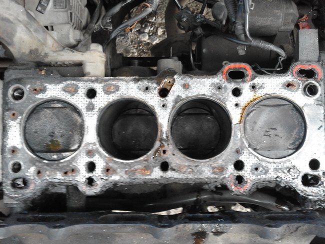

Already removed the cylinder head. How do I clean all of these? Thanks!
Aug 29, 2018 at 5:03 AM
Okay, you will need an air drill or electric drill with an adapter to use what is called cookies. They are nn abrasive discs that will remove gasket material without damaging the block surface.
You can get them at a parts store. Get a box of the cookies. They are cheap but you will need to get the adapter to fit the cookies.
Aug 29, 2018 at 6:07 AM

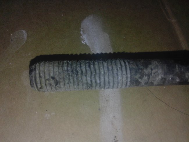

Okay, I will try to look for those. I noticed something about head bolt number 5. Is this something to be worried about? My guess is that coolant seeped in its bolt holes and left some sediments on the threads when it dried up. Am I correct? Please see picture.
Aug 29, 2018 at 10:33 PM
Yes, that is correct.
I would run a tap down and clean up the threads. Take one of the bolts with you to get the exact thread pitch for the tap.
The 5 is most likely a production line number.
Aug 30, 2018 at 1:22 AM

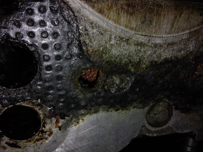

As I was cleaning the cylinder head surface I came upon a big pitting. Will this be an issue?
Aug 30, 2018 at 3:58 AM
Clean the top of the entire block and then we will take a look.
Aug 30, 2018 at 4:11 AM

Roy, none of our auto parts store here in the Philippines have the one you said "cookies" or any gasket remover. I already have an adapter for the drill. Can I improvise and just use scotch brite to remove the old gasket material?
Aug 31, 2018 at 9:26 PM
Yes, that will do fine. Clean the block as best as you can.
