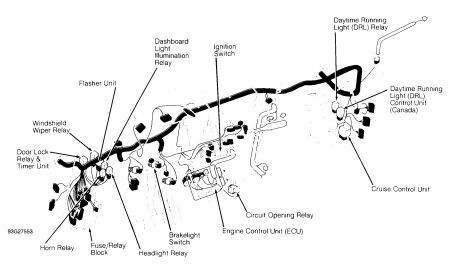

hi can you tell me where is situated the computer

The ECU is located behind the center of the dash
https://images.2carpros.com/forum/automotive_pictures/1639_mazda_1.jpg
