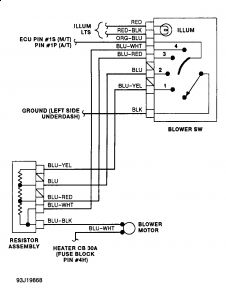

I just bought this car and I'm really not familiar with Mazda's nor blower motors for that matter. I don't hear anything when I turn the hear/ac. I want to check the fuse but don't know what fuse it'd be. There's not one for blower.
If the fuse isn't blown...how would I go about getting to the blower motor...I pretty much just need to know where to start, I can probably handle it once I know i'm starting at the right spot.
thanks!

Behind glove box gain acess to blower motor and resistor. With test light check voltage to motor if present replace motor if not check voltage to resistor if present replace resistor. if no check power at switch. see figure
https://images.2carpros.com/forum/automotive_pictures/198357_Graphic_86.jpg
