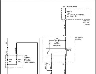

1988 Mazda 323 4 cyl Automatic 200000 miles
I was wondering if you would be able to tell me the wiring configuration for the alternator in this vehicle? What happened was my old altenator bombed out but the new one I put in didnt work, so I tried again and got the same result. I think that the wiring was changed in the original alternator and hence the harness has been changed aswell. Is it at all possible for you to tell me where L and S etc wires are supposed to be connected throughout the alternator... or would you be able to send me a wiring diagram at all?

this help any?
https://images.2carpros.com/forum/automotive_pictures/261618_Noname_451.jpg
https://images.2carpros.com/forum/automotive_pictures/261618_Noname2_202.jpg
