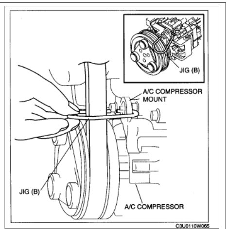

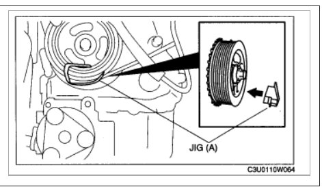

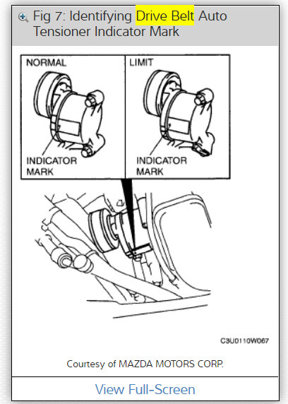

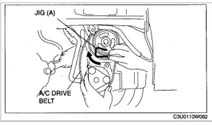

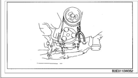

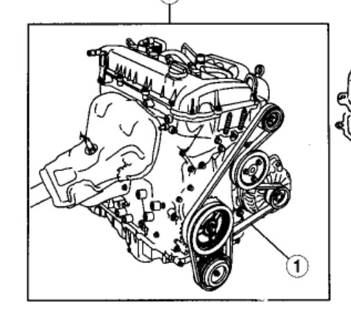

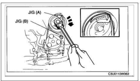

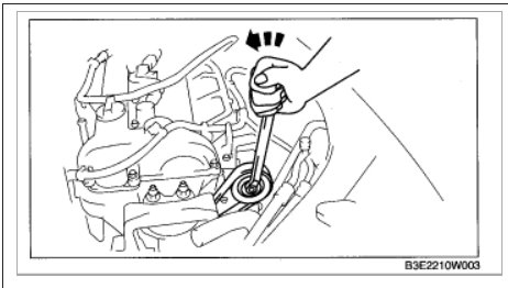

I am rebuilding a Mazda 3 with the 2.3 turbo and the drive belt was missing. There is no diagram (hood was missing) and I am about to go crazy trying to figure out how to route the belt. Thanks for any help possible!
Dec 29, 2008 at 10:58 AM
RACEFAN966
  • 5,029 POSTS
Hello, here is what I found for you.
Cheers
