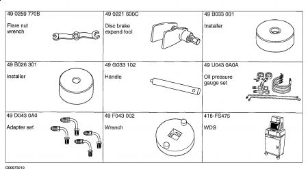

I have removed the old rear brake pads. I've obtained a large enough C- clamp to depress the piston. It appears that I've can't get the piston to depress anymore yet I don't have enough room to put on the new pads and reinstall the caliper.
updated 11/28/09

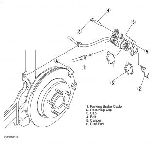

I was able to run down this tool from Auto Zone and it made all the difference in the world. I have a new problem however. I have figured out how to attach the pad with the clip on it to the caliper piton, however, I can't figure out how to attach the retainer once the pad is on the piston. Please advise.

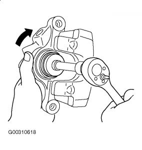

Need a tool that rotate piston to retract see diagram tool F043 002
https://images.2carpros.com/forum/automotive_pictures/198357_Grafic_3_81.jpg
https://images.2carpros.com/forum/automotive_pictures/198357_Graphic_275.jpg

See diagram
https://images.2carpros.com/forum/automotive_pictures/198357_Graphic_287.jpg
retainer clips over caliper then it will press against the mount to keep pad from rattling. Trick hear is to only take apart one side at a time so you have a template
