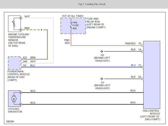

Hi NotTooBad,
You must be losing power somewhere there is a 40 amp fuse that runs the system can you check to see if there is power at it?
Here is a guide
Here is a wiring diagram so you can see what's going on. (below)
There is also a temperature switch that could be bad as well. Also check the grounds for the control module.

Neither me or my mechanic could figure out the problem with electric fan failure. One think that make it worst is that sometime it works and sometimes it doesn't. When it stop working the aircond gets warm and the car get heated.
I have sent it to authorize Mazda service center and they think that nothing is wrong (as the fan still working) and reset the car ecu. After a few days driving all of a sudden the fan stop. I have to park it along side of the road to prevent engine overheating and get it tow to a garage. The next day when the mechanic turn on the engine, the electric fan works. Why? This happen so many times. Please help.
May 22, 2009 at 12:41 AM
KHLOW2008
  • 41,812 POSTS
Hi virach, Since the problem is intermittent, it most probably is caused by a faulty sensor, fan control module or bad ground connections. Remove the ground wires behind both the headlights, clean and reinstall and retest if symptom goes away. I have the schematic here for your understanding of the circuit.
https://images.2carpros.com/forum/automotive_pictures/192750_CoolingFan06Mazda3_1.jpg
When problem happens, did the Check Engine Light come on while driving? You mentioned the Mazda SC reset the ECU, were any codes retrieved then?

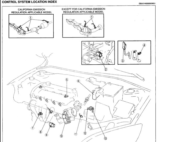

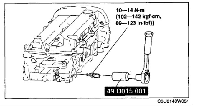

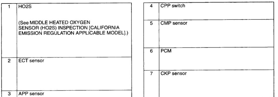

where do i find the sensor reply wit photo if u have one
Nov 3, 2017 at 11:01 AM (Merged)
  • 55,588 POSTS
Sure the sensor is located at the rear of the right side of the cylinder head. Here is a guide to help you see what you are in for when changing the sensor out.
https://www.2carpros.com/articles/coolant-temperature-sensor-cts-replacement
Here are some diagram (below) of where the coolant sensor is.
