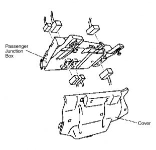

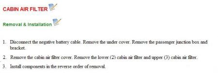

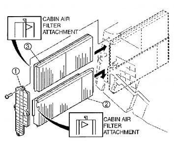

Does my 2004 Mazda 3 Hatchback have a cabin filter? And if so, where is it located?
