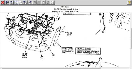

2004 Mazda 3 Two Wheel Drive Automatic 96000 miles
hi,,,Thank you for helping as. I fix already the cable inside de transmition, bad the car still not recognize that is in parking (P) and it wont start, unless i switch to Neutral.....it starts sometimes but other times it does not. I was wandering if i have to change the neutral switch or adjust it. If so, could you tell me how much would it cost me in canadian dollars....? thank you.
Ric.
Dec 6, 2009 at 4:52 PM
  • 75,992 POSTS
Replace the NS its on near rear of engine-see below
https://images.2carpros.com/forum/automotive_pictures/12900_NS_1.jpg
