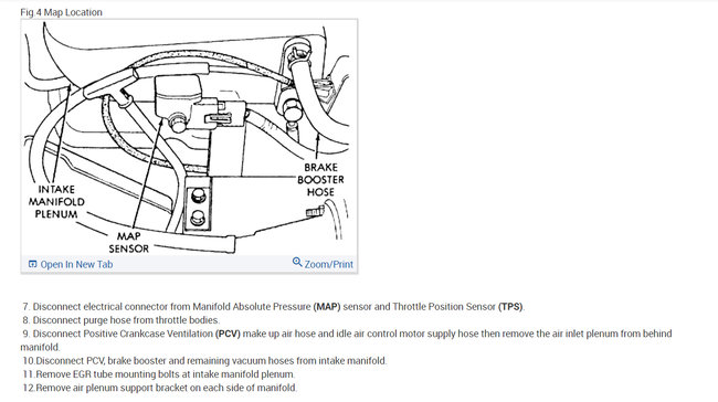

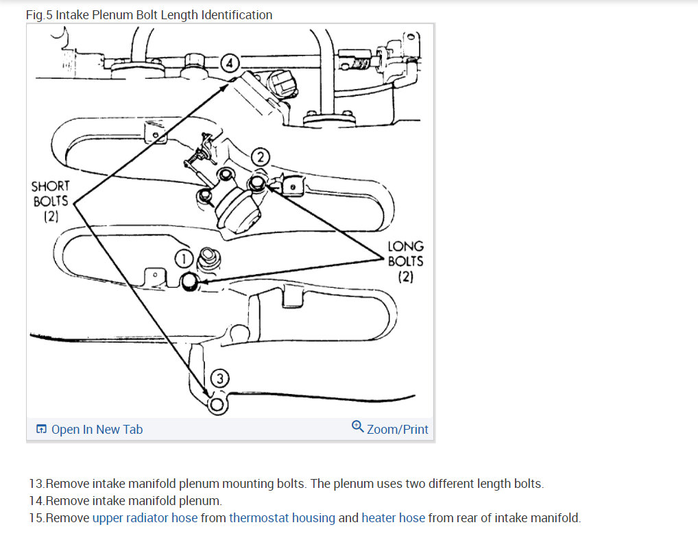

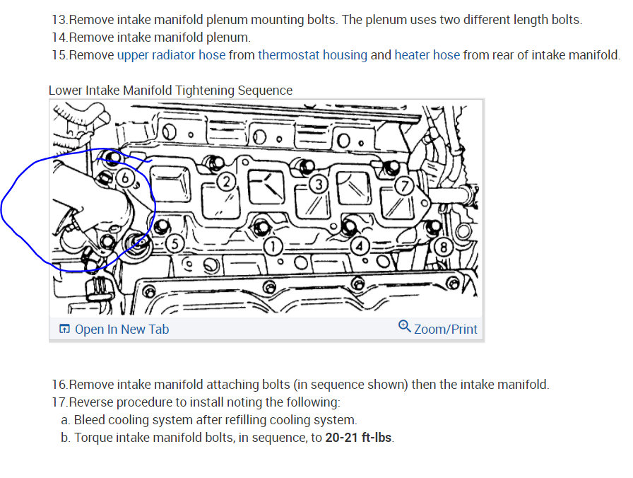

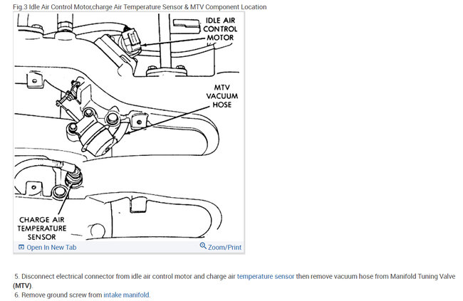

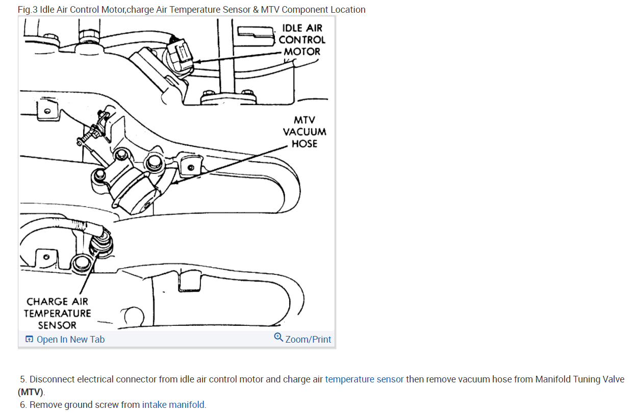

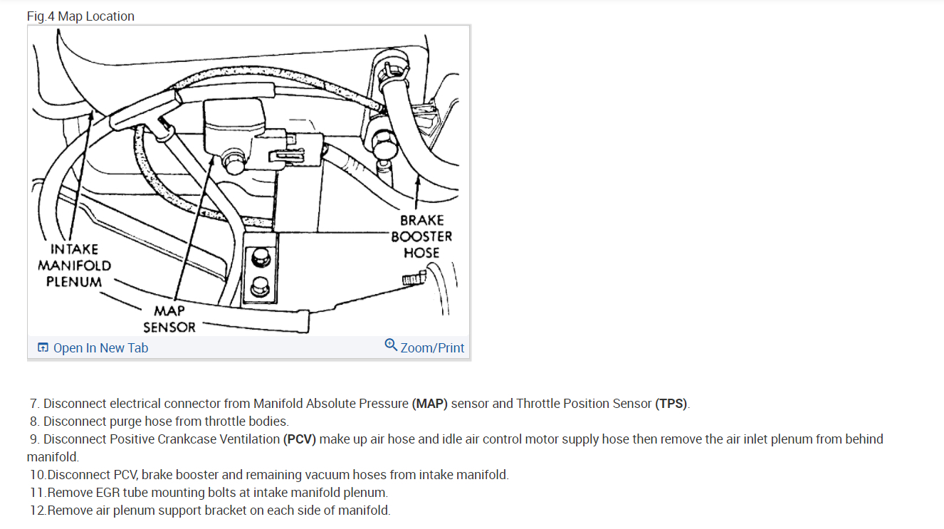

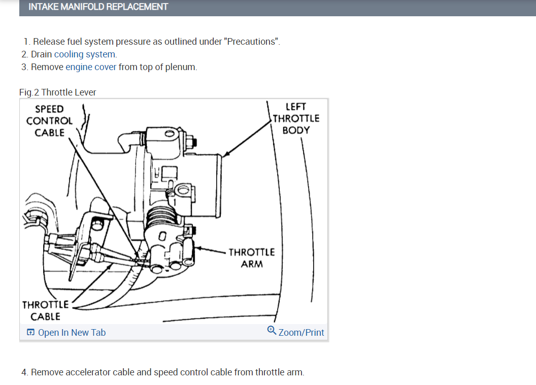

The intake manifold needs to be removed to access the thermostat. I attached the procedure for you below.
https://www.2carpros.com/articles/replace-intake-manifold-gasket
