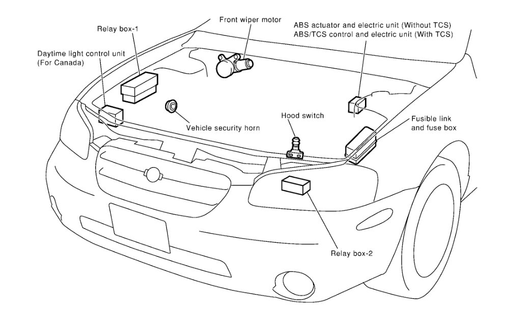

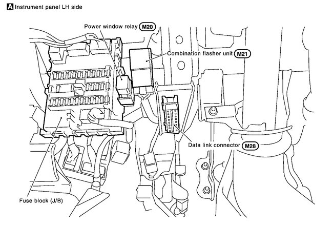

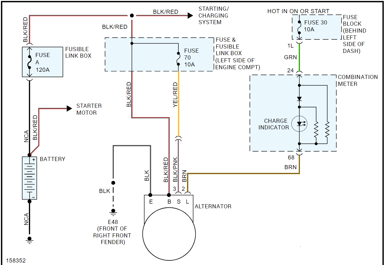

You are doing good, there are three fuses to check one is a fusible link or maxi fuse. Here is a guide to help test them and the fuse location in the images below and I have included the alternator wiring diagrams so you can see how the system works.
This guide can help as well. I would check for power at the main power lead of the alternator.
Check out the images (below). Please upload pictures or videos in your response of the problem so we can see what's going on. Check fusible A, fuse 70 in the fuse panel on the left side of the engine compartment, and fuse # 30 in the fuse panel on the left side of the dash.

Hi. Thank you so much for the help. I got it to charge again. I ran through the steps you provided. However, it wasn't a blown fuse. I honestly don't know why it is charging again. I'm not sure if it will continue to charge or not. If it stops charging I'll ask for help again. Thank you.
Jan 31, 2024 at 8:44 AM
  • 55,711 POSTS
It sounds like the alternator might have an intermittent shorting issue, but it could have been a bad connection which is now fixed. Thanks for letting us know.
