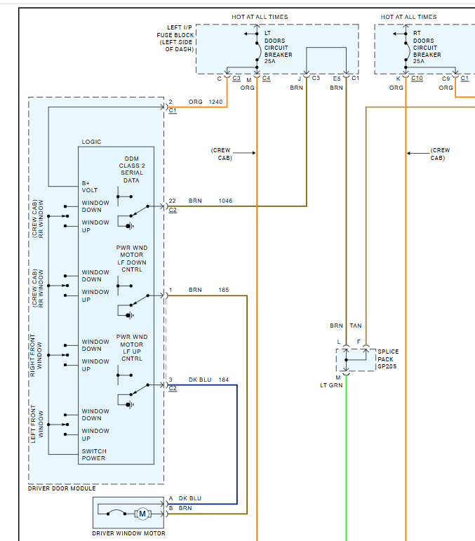

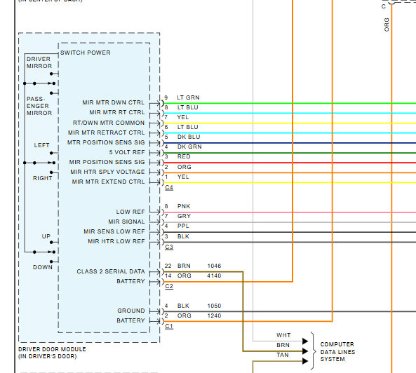

I have cut off my 26 pin master window switch wiring connector and can’t make it work there are 13 wires and have only able to get the driver side mirror to move up down left right it is a extended cab power windows not folding power locks

I assume you need the window wiring diagrams for the switch correct? These diagrams show which wires goes to where in the window/mirror switch. Check out the images (below). Let us know if you need anything else. Ken
