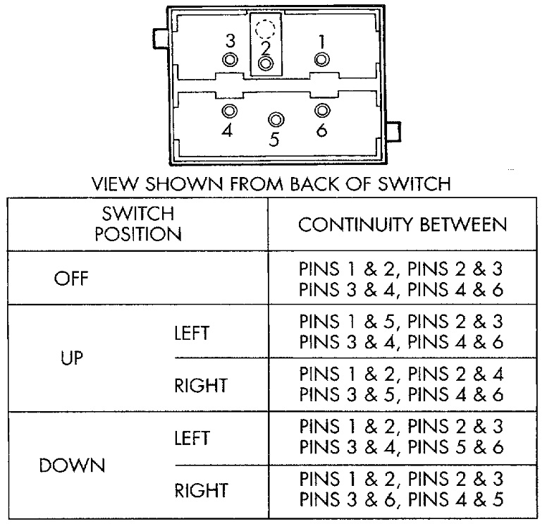

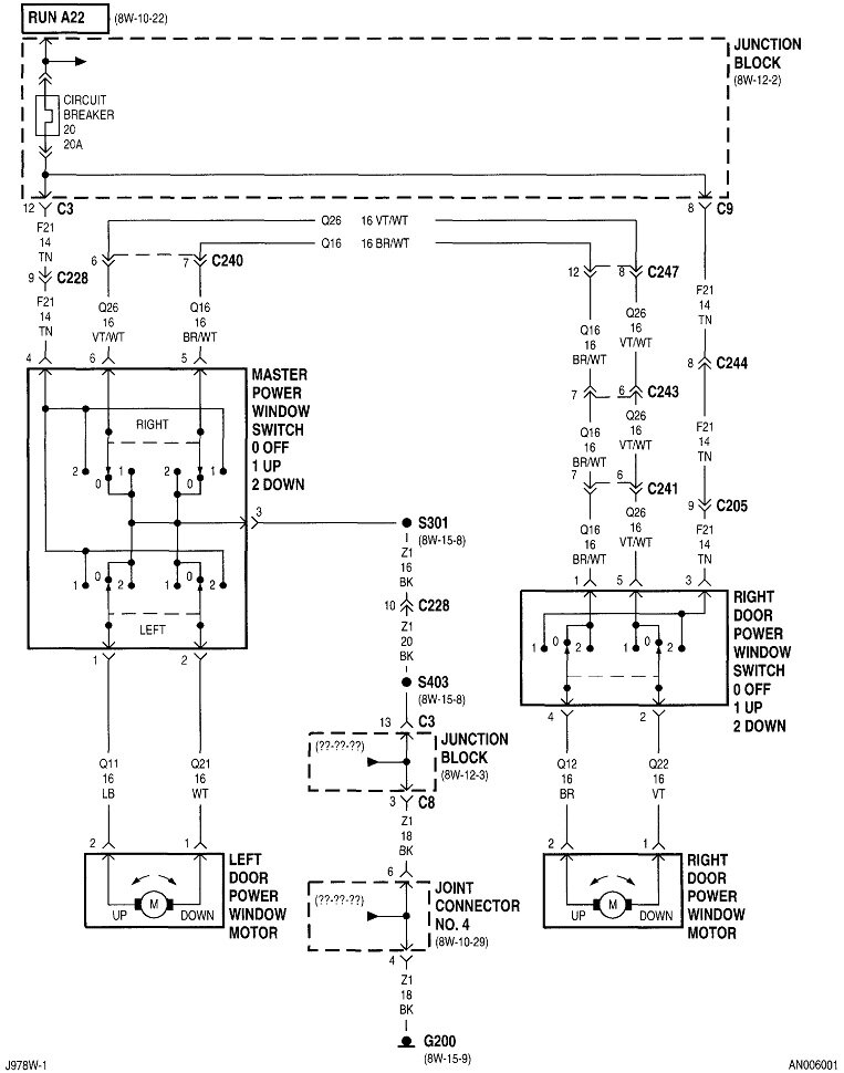

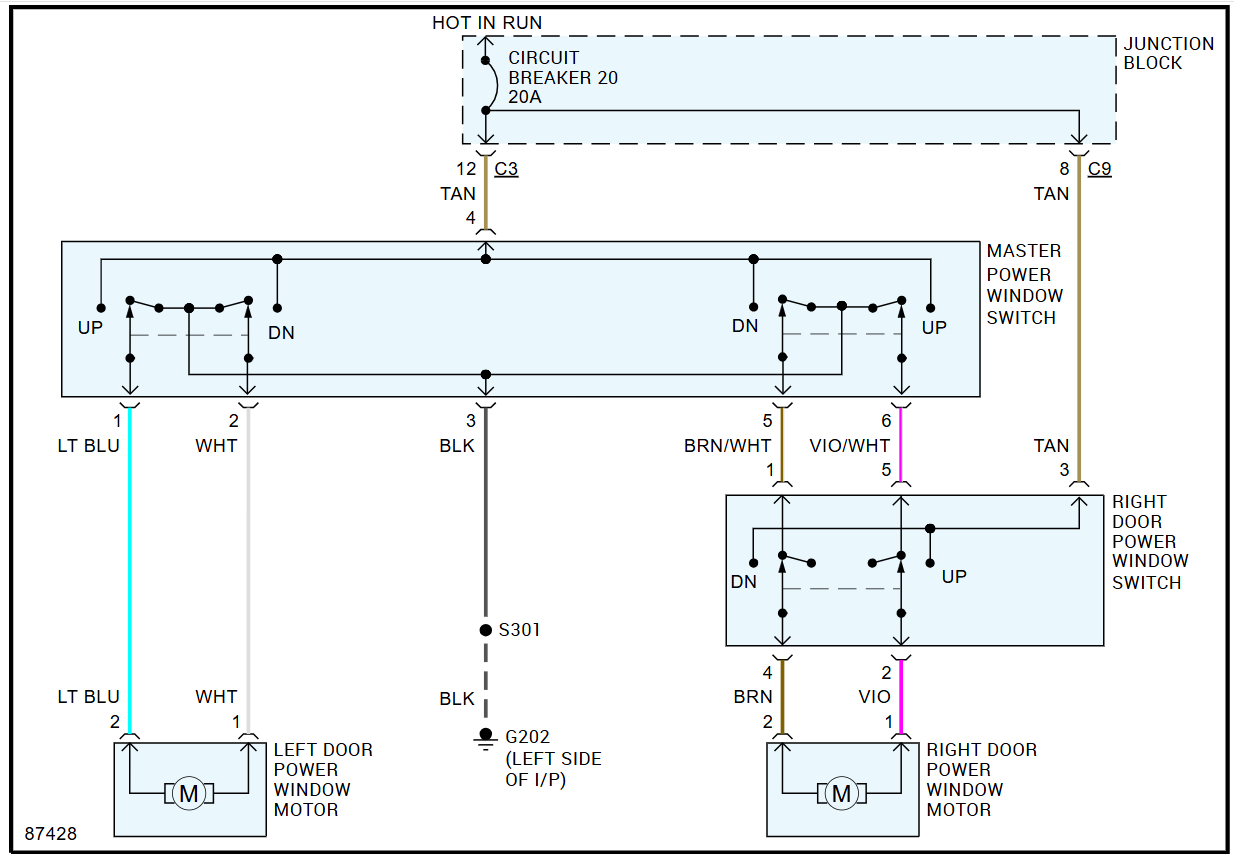

The master window switch wiring was cut and I got a new switch and I'm trying to figure out which wires go where to rewire this back right.

This is the diagram for the power windows. The second drawing shows the driver's switch terminal layout. Let me know what you need help with.
