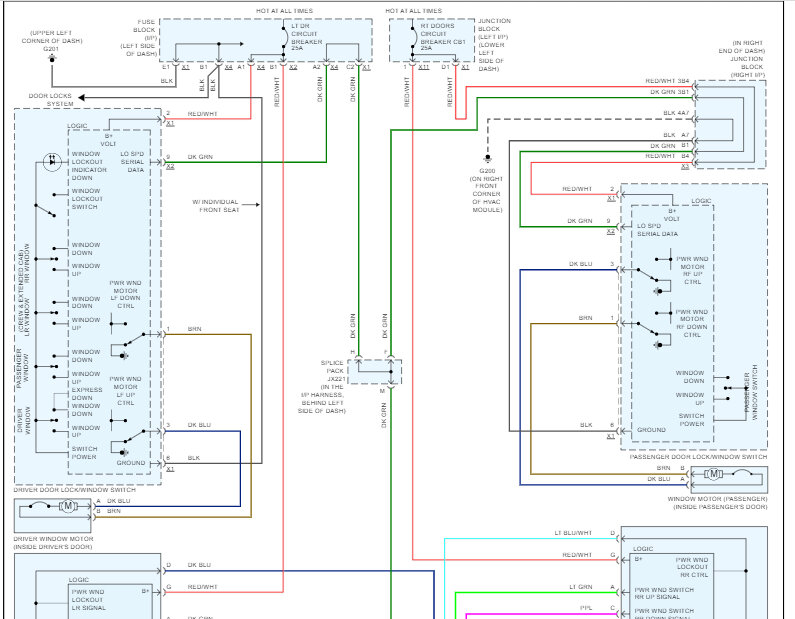

I bought a new master switch because mine burned. The side mirrors, passenger and back door windows don’t work only drivers front works. I had to change the plug and I had to splice and put new pins on. I may have switched one by accident. I am looking for the wiring diagram that goes to the plug that controls everything. There are 5 wires coming into the black plug.

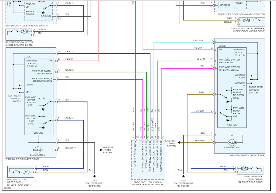

Believe it or not, there are two different designs. They are identified by RPO numbers. However, the one thing I noticed is there are 5 wires going to the master switch with RPO AN3/DL3. So, that is what I attached.
Take a look at the schematic and identify the wire colors on your connector to confirm.

See pics below. Note: I cut the schematic in half to make them readable. I did overlap them.
