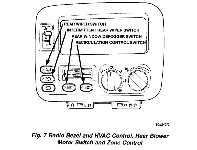

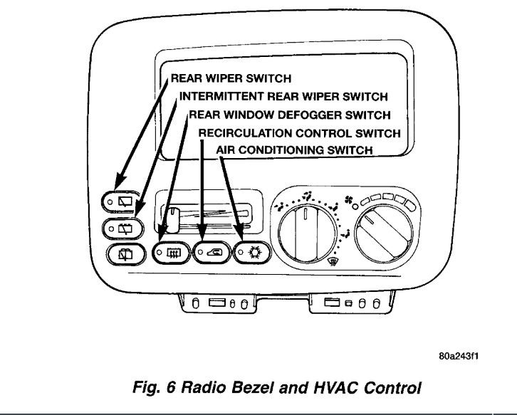

I attached the procedure for resetting the lights.
GENERAL INFORMATION
If the Heating Ventilation and Air Conditioning (HVAC) control module is replaced, the Calibration Diagnostic and Cool-down tests will need to be performed. Once this group of tests have successfully passed, they can be performed individually. The engine must be running during the test to provide hot coolant for the heater, A/C compressor operation and to assure that the actuators are calibrated correctly. The HVAC control module is capable of troubleshooting the system in approximately 120 seconds. If a condition is detected, an error code is displayed. The error code cannot be erased until the condition is repaired and the diagnostic test is performed. Check wiring before replacing components.
CAUTION: Do not remove the actuators from the Heater-A/C unit assembly with power applied. Removal should only be done with the Ignition OFF. The actuators have no mechanical stops to limit the travel. If the actuator rotates and is not connected to the unit assembly, it will become out of calibration.
Radio Bezel and HVAC Control
Radio Bezel and HVAC Control w/Rear Blower and Zone Control
ACTUATOR CALIBRATION
Mode, Blend and Zone (if equipped) door calibration compensates for mechanical variations in the actuators, HVAC control module and its linkages. In vehicle calibration can be entered from the control's front panel. If the REAR WIPE and INTERMITTENT LED's flash simultaneously when Ignition is cycled ON, the actuators have not been calibrated or during the previous calibration a failure occurred. Diagnostics will always occur during Calibration Diagnostic and Cool-down test.

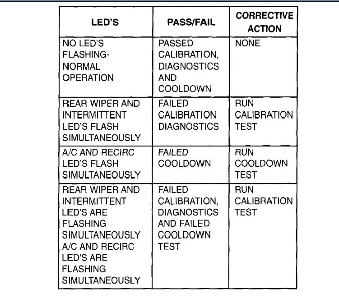

CALIBRATION/COOL-DOWN LED DISPLAY CODES
Calibration/Cooldown Test LED's
NOTE: See chart for definition of flashing LED's. If no problems are found, the control functions normally.
CALIBRATION/DIAGNOSTICS TEST ENTRY
TO INITIATE TESTS:
- Set Blower motor ON HIGH
- Set Mode position to Panel
- Open all A/C outlets
- Set Temperature to Cold (Both slide pots if equipped)
- Depress WASH and REAR WIPER button simultaneously for 5 Seconds (Until all LED's light)
RESULTS:
- All LED's will turn on for 5 Seconds
- Calibration Test is running when REAR WIPER and INTERMITTENT are alternately flashing. Cool-down test is running if A/C and RECIRC are alternately flashing.
- Acceptable result is REAR WIPER LED is the only LED flashing. Push Rear Wiper to exit.
- After all tests have passed, Calibration Diagnostics and Cool-down can be run separately.

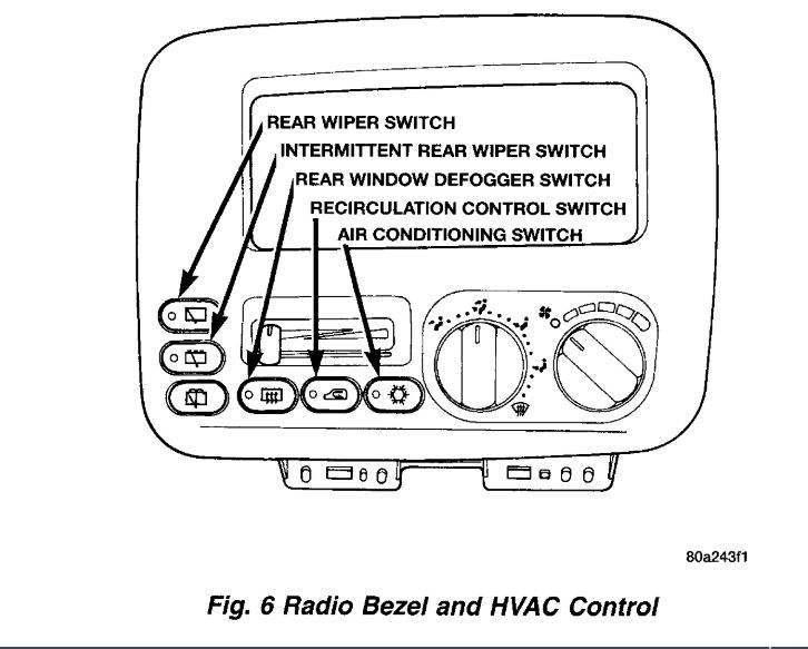

COOL DOWN TEST ENTRY
NOTE: Prior to start of test, If the evaporator is already cold, the system will fail test. To correct, operate system with A/C OFF and the blower motor ON high for three minutes prior to starting test.
TO INITIATE TESTS:
- Depress WASH and A/C simultaneously for 5 Seconds
RESULTS:
- Cool-down Test is running when A/C and RECIRC are alternately flashing. If A/C and RECIRC are flashing simultaneously, Cool-down has failed.
