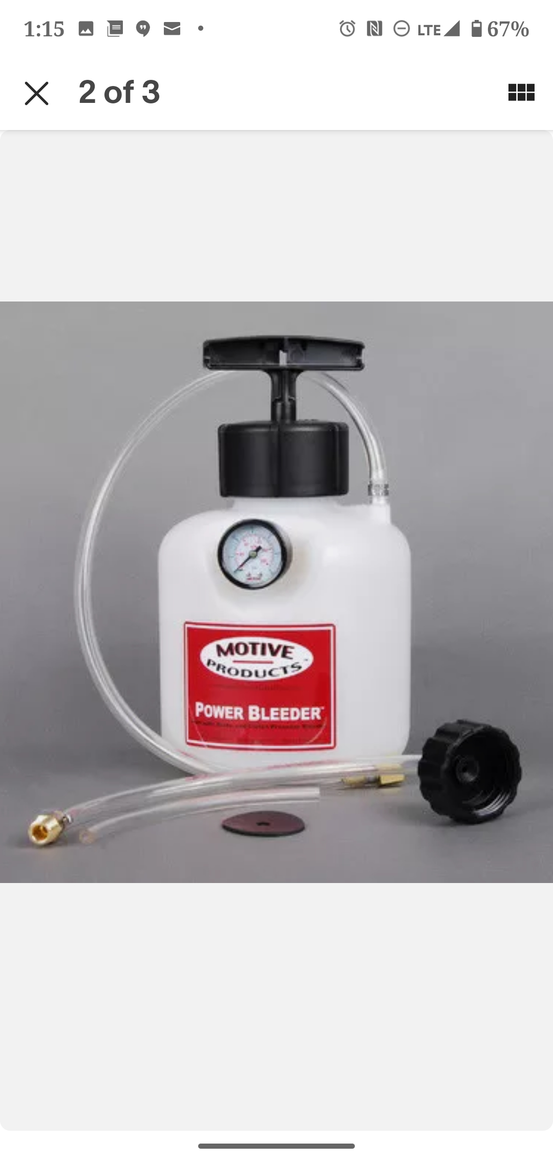

I think the pressure bleeder is your entire problem. If your alone I would gravity bleed it or if anything pull the fluid to the caliper with a hand gun style vacuum pump. We're going to have to assume there is air in the abs manifold too so you will have to crack each line at the manifold first and make sure the manifold is air free. But for now can you send me the model bleeder you are using so I can look into it specifically and we can go from there? Bleeding this car shouldn't be an issue its a pretty straight forward thing.

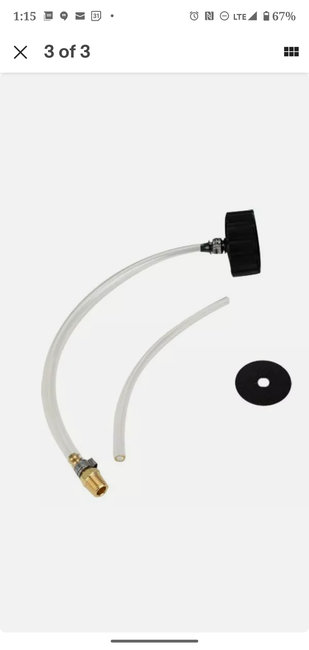

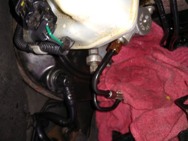

I gravity bled the master cylinder with a shop towels underneath. When I finished one or the towels was soaked another partially although, I what I noticed was not a heavy drip but a steady one. Especially, from the port closest to the firewall. The other port didn't seem to drip as much but it was definitely wet around it. After about an hour I took an adjustable rod from my bike repair stand which, holds the front wheel steady. Adjusted so it could take the place of my foot when wedged against the seat. I then depressed the brake pedal slowly about ¾ of the way to the floor. Then put the rod in place, went back to the master cylinder and tightened the port connections. Then released the rod. I repeated this procedure 4 times.

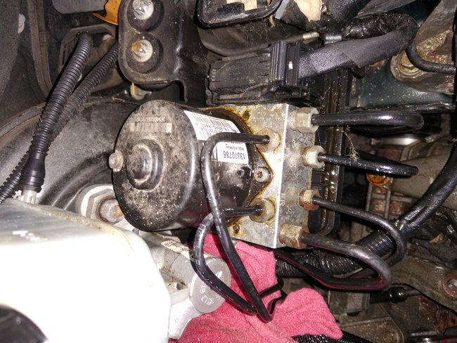

At this point I moved on to the ABS Manifold. Again, placing shop towels under it and loosened all 4 connections (I have attached pictures of these and the pressure bleeder you wanted). I let these bleed for about 50 minutes but had to go.

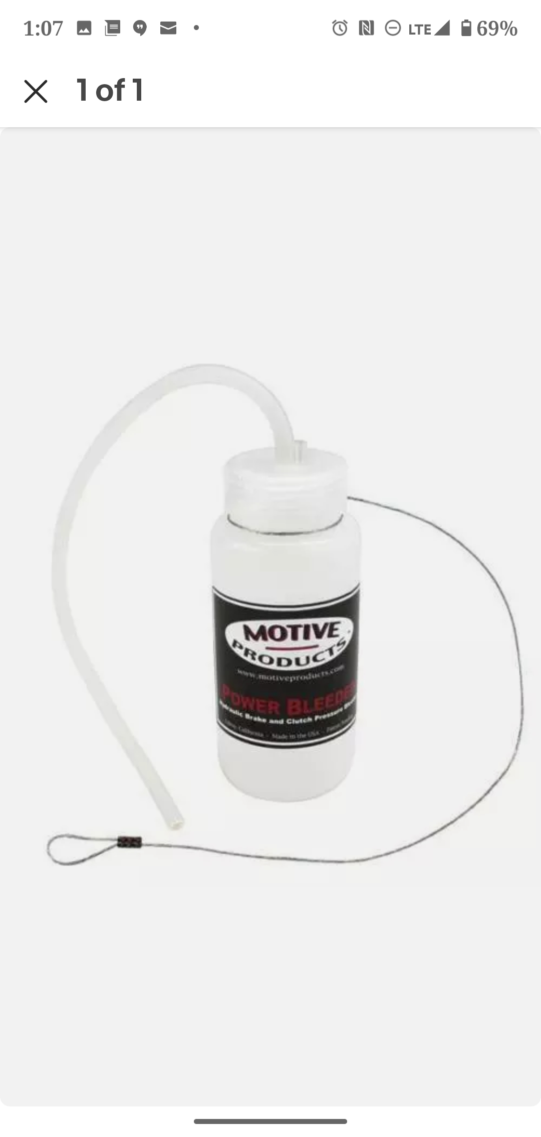

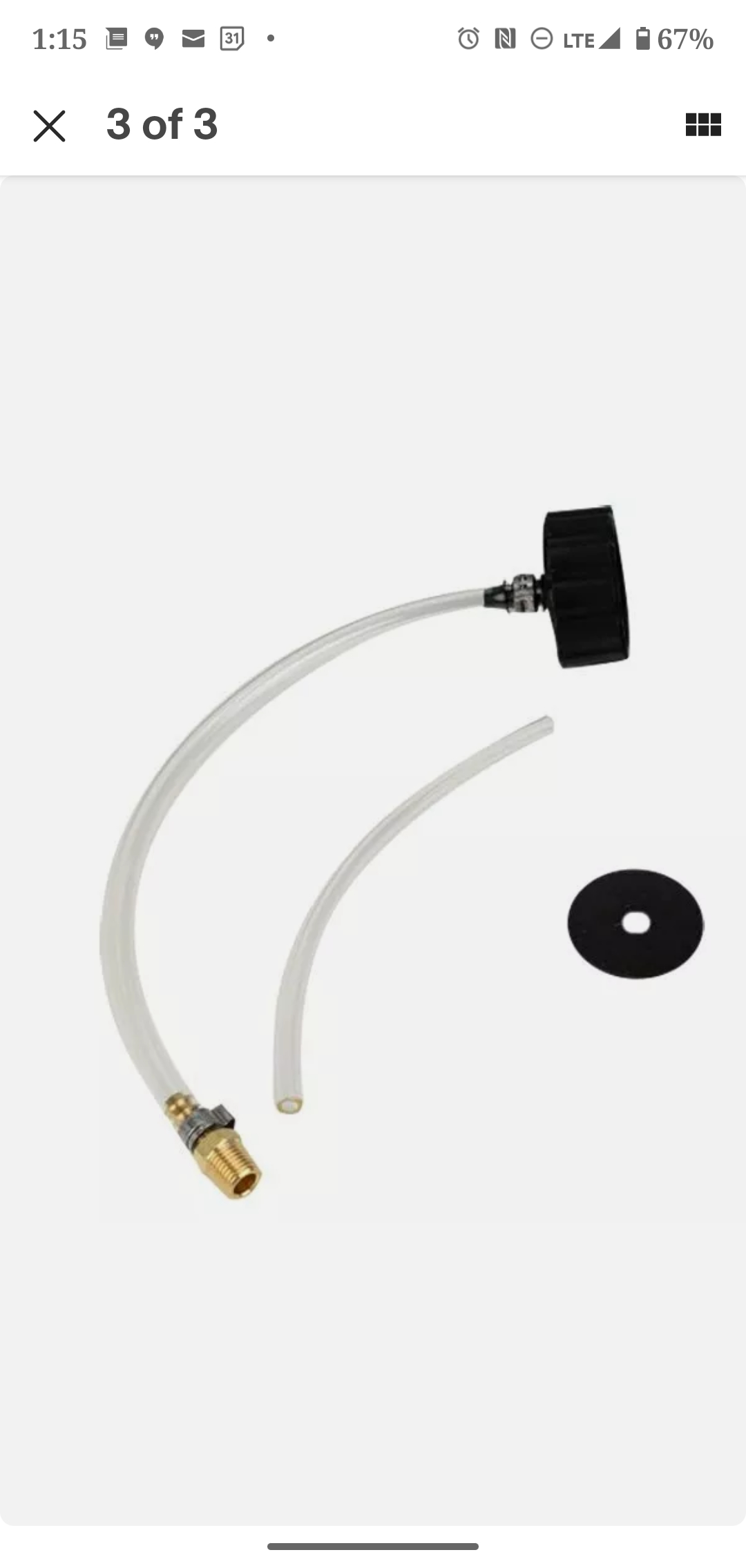

2) He uses the same bleeder as mine. Except mine is older and he has some fancier fittings for the reservoir which, were not even offered when I bought mine. Mine is a black plastic (threaded – initially, it came with a 3 tab which was wrong so, we exchanged it for the correct screw on type). Also, be does not recommend using the plastic ones as they tend to warp causing a bad seal. Also, he reminded me of cutting all the ends of the tubing for a good fit as they swell. I was only cutting an end if I noticed something wrong. He also has quick disconnects in the hose between the reservoir and the tank. I tried to find a swivel coupling (to keep the hose from twisting when screwing it onto the reservoir) but couldn’t in that small size. So, I wound up using a union which works and would be okay if I could have found a brass one as they are smaller (I believe). I wound up with a galvanized union which seems to work ok and spraying with a soap solution appears tight. But it is big and heavy.
He also mentions about getting air in the ABS spool valve and that it was a nightmare for a friend of his to get out. But if air does get in their can't I fool the system by bring it to an impending lock or an actual lock of the wheels to activate the spool hence, getting the air out that way???
If your interested in looking at this video: https://youtu.be/_uavUdIT2-o”
I've attached pictures of the bleeder you wanted and a couple of the master cylinder and ABS Manifold.
