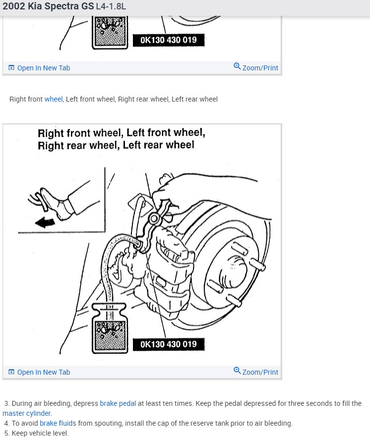

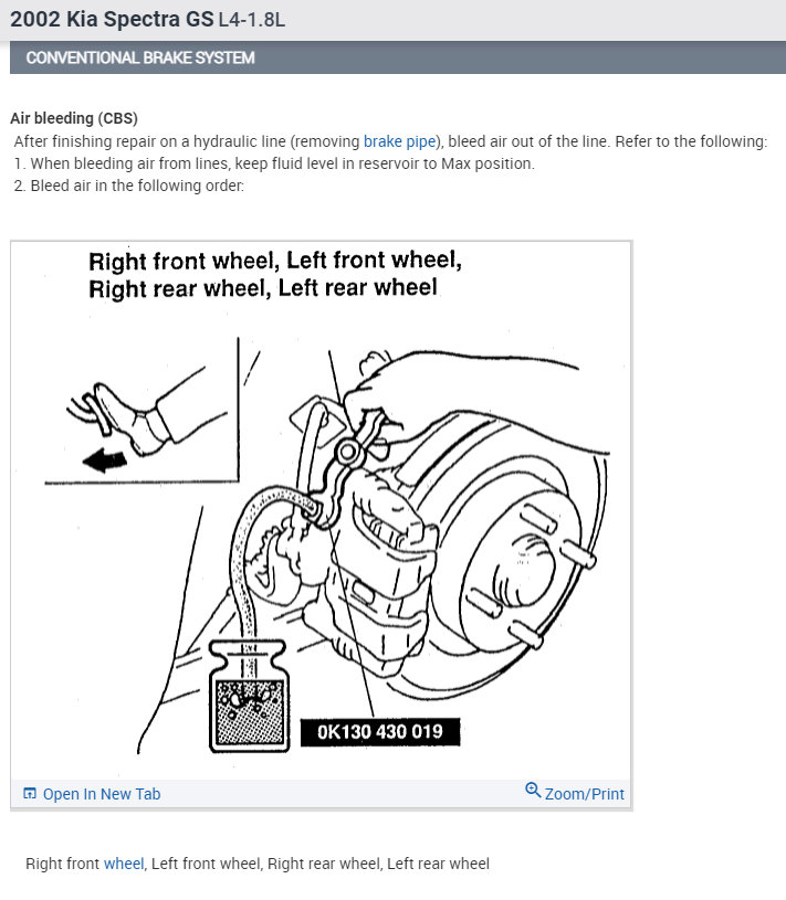

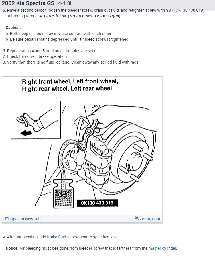

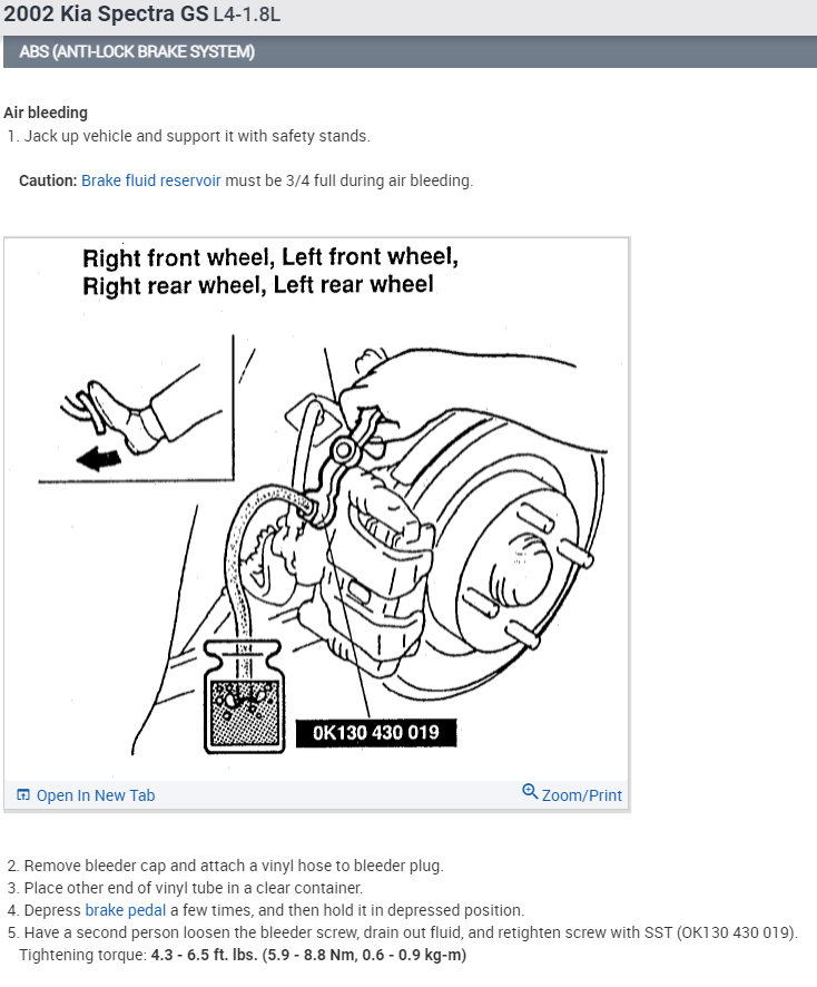

What is the proper brake bleeding sequence for this vehicle?
Feb 16, 2016 at 6:22 AM
SQM
Experienced Mechanic
6,383 POSTS
Depending on if the vehicle is equipped with ABS or non-ABS brakes, the procedure is little different.
I have attached the procedure for both brake systems.
https://www.2carpros.com/articles/how-to-bleed-or-flush-a-car-brake-system
