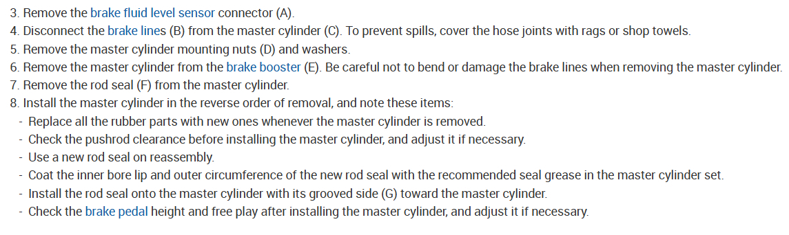

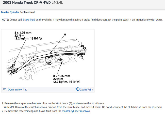

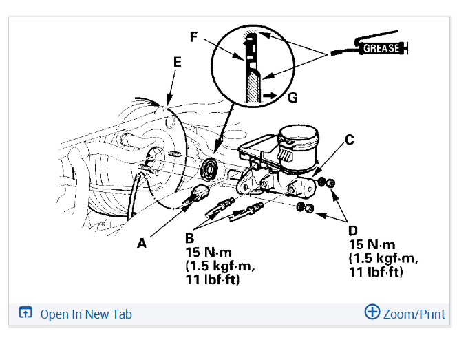

Yes, it sounds like it, how old is the brake master? Here is the correct way to bleed the new brake master on the bench before installation:
https://www.youtube.com/watch?v=WDxvEQrMkBg
Here is the correct way to install the brake master. Check out the images (below). Please let us know what happens.
