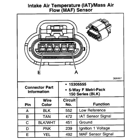

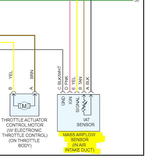

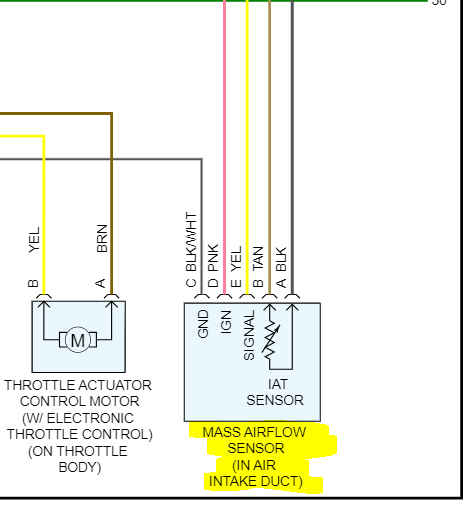

If you look below, I attached two pics. One of the pics shows the sensor wiring and colors. Also, it indicates the letters of each connector pin at the sensor.
Pic 2 shows the connector pin-out for the MAF. Let me know if that is what you are looking for or if you have other questions.

Question for you. So, if I’m looking at this from the front of the hood how would I wire this? Currently I have it like this. Blk/white- Pink- Tan/Blk- Tan- Yellow.

Do you see the connector view in the diagrams above?

My sensor connection is yellow, pink, black, tan/black strip and last tan. Why is the picture stating something different then what I have on mine?

Can you upload an image so I can see it?
