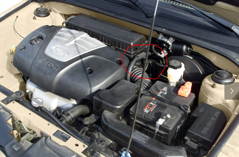

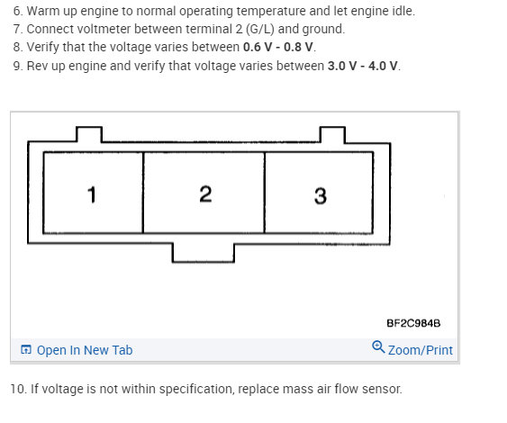

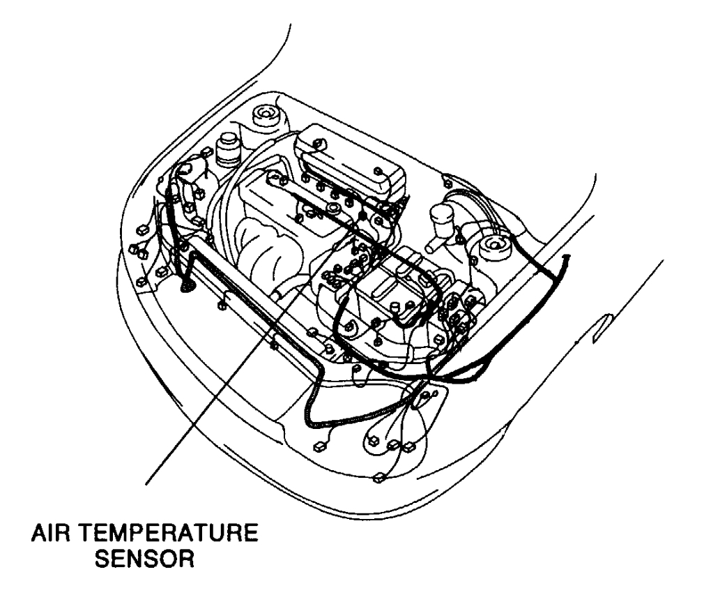

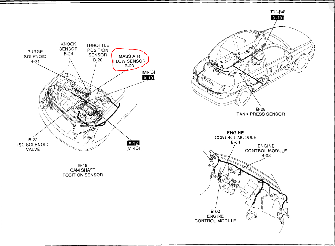

Need to locate all three of the above-mentioned sensors. hope you can help.

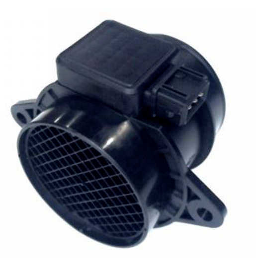

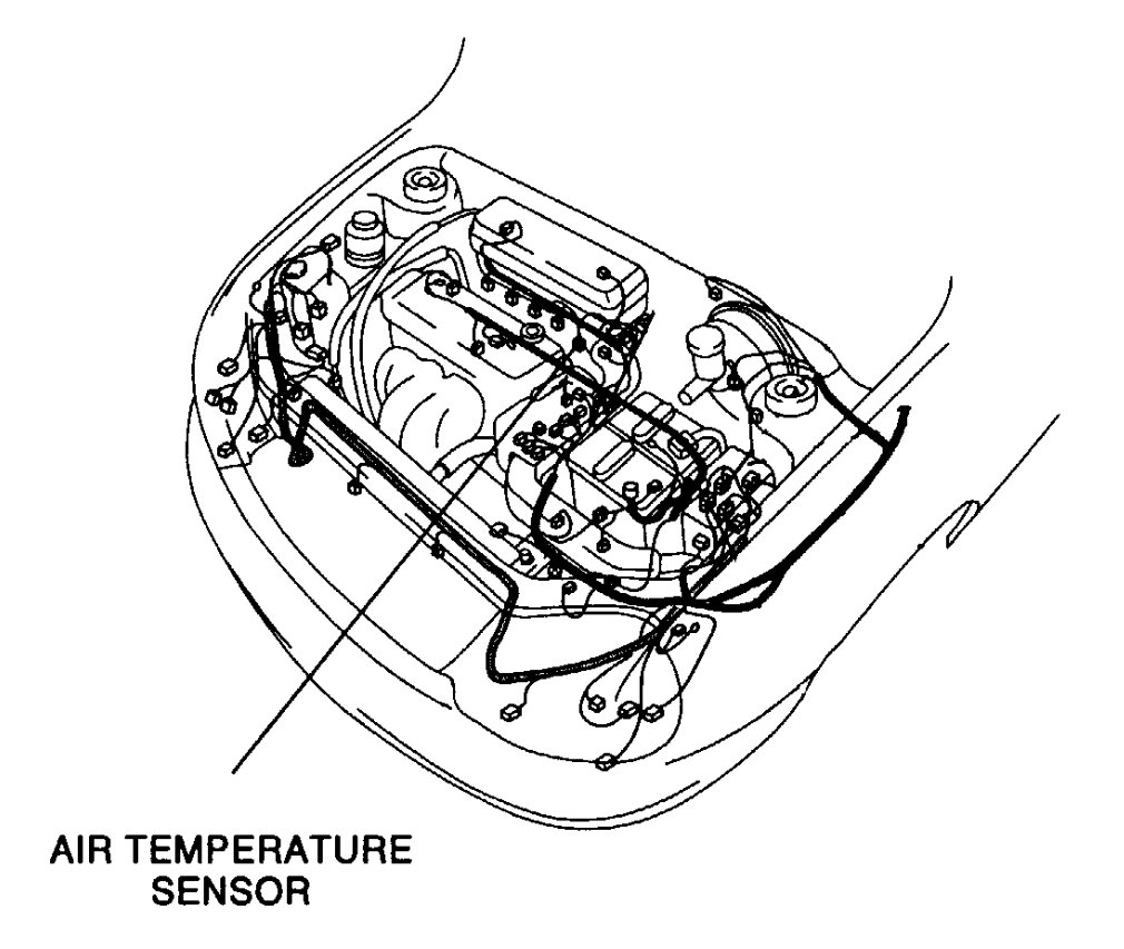

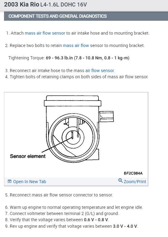

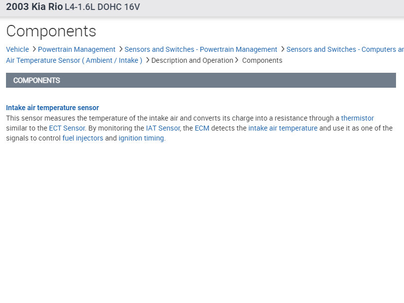

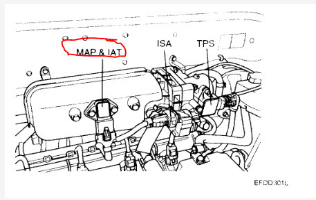

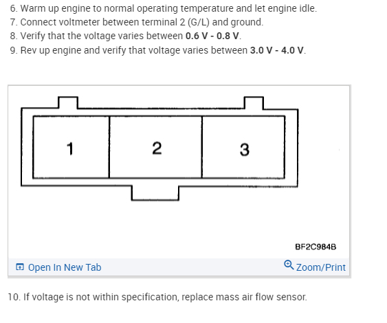

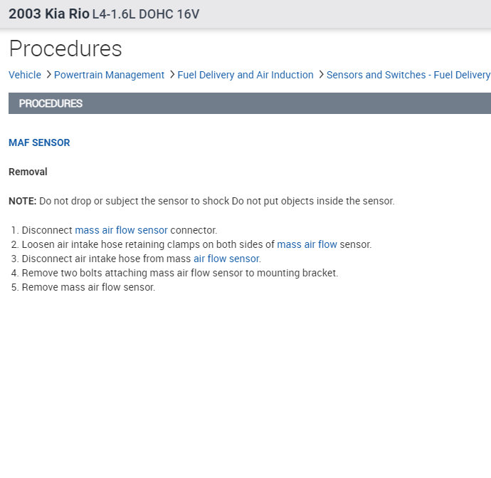

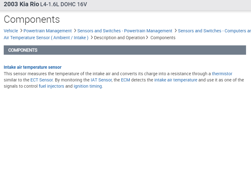

The mass air flow sensor is located at the end of the air tubing by the air filter box.
The IAT and MAP sensor is located under the air box.
I have attached diagrams and pictures below for your reference.
