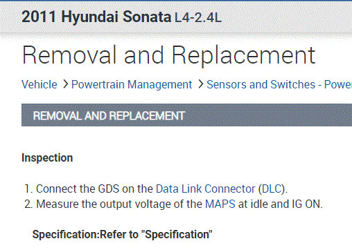

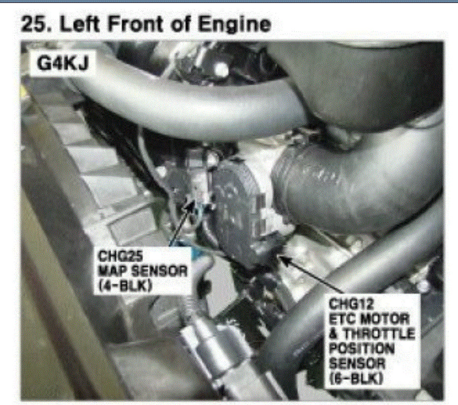

I have some mass airflow cleaner and wondering where the mass airflow sensor is and what I need to do. I've done them a couple times before but never to the vehicle I currently own.
May 1, 2021 at 9:02 AM
  • 110,190 POSTS

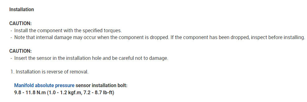

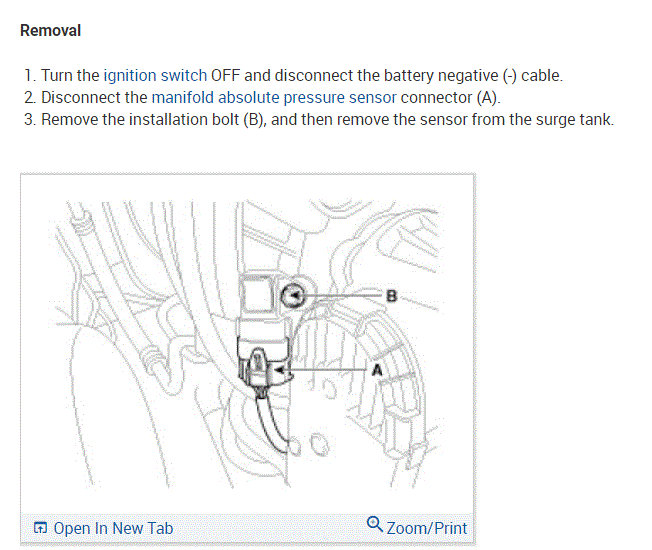

The MAP is located on the left side, in front of the engine. See pic 1 below. The remaining pics are the directions specific to removal and replacement.
Additionally, here is a link that shows how to service one:
https://www.2carpros.com/articles/mass-air-flow-service
