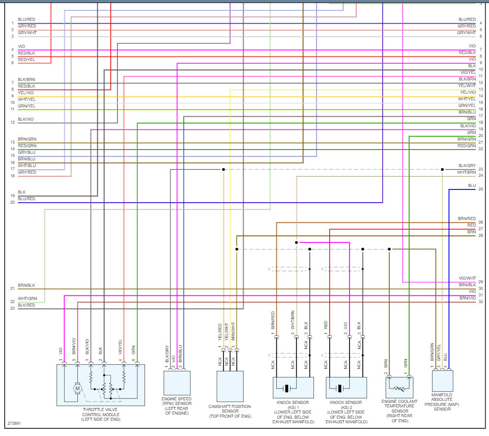

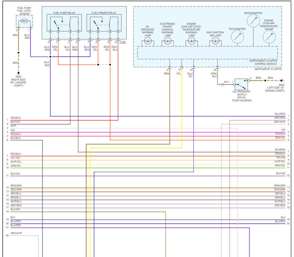

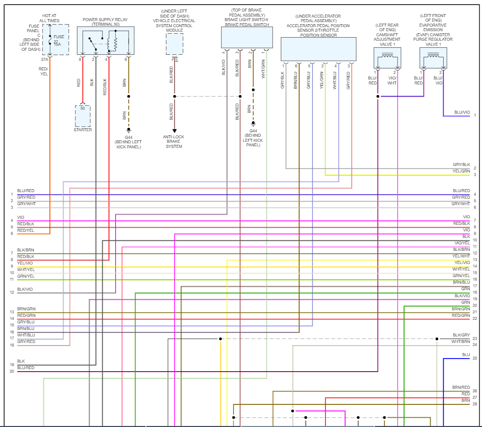

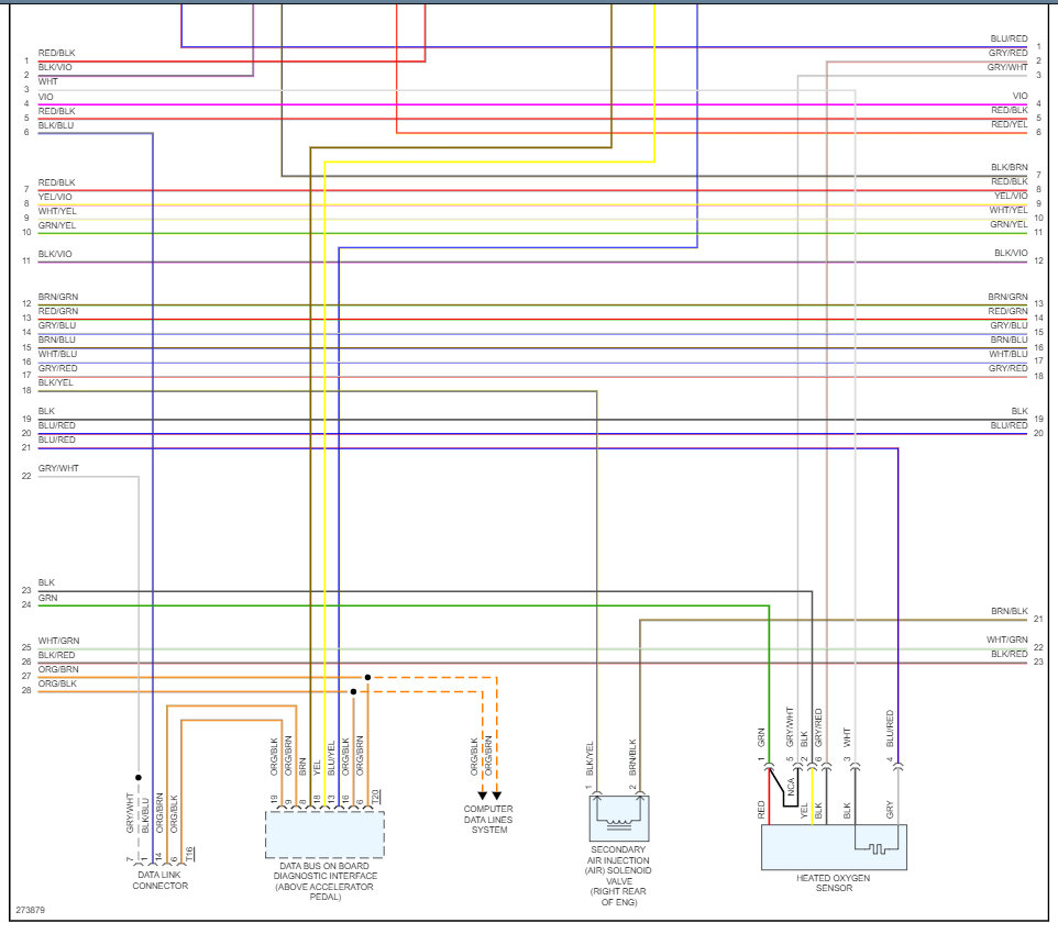

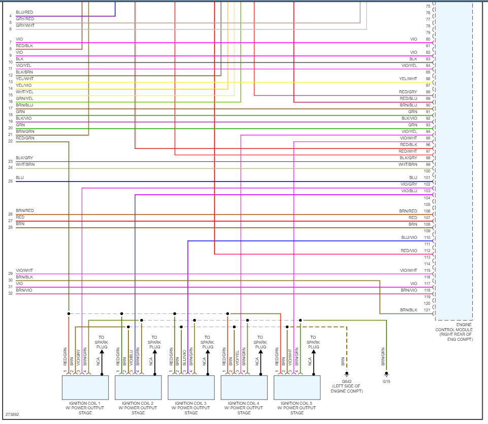

I replaced the Mass air flow sensor on the car listed above, with no change. I was told to check the wiring ground coming from the wire harness goes where. thank you
Mar 24, 2023 at 12:33 AM
  • 55,721 POSTS

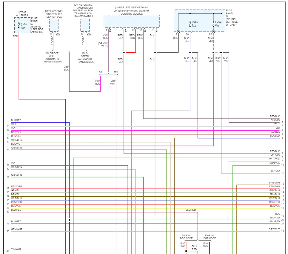

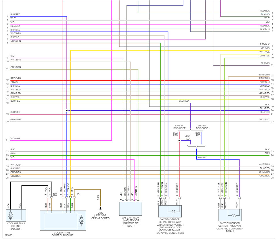

Here are the engine and mass air flow wiring diagrams in the images below. I have included a guide on how to check the connection as well.
Check out the images (below). Please let us know if you need anything else to get the problem fixed.
