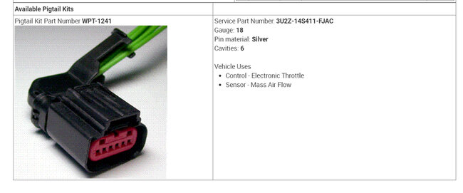

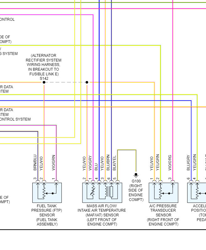

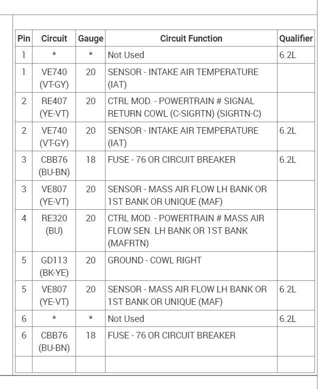

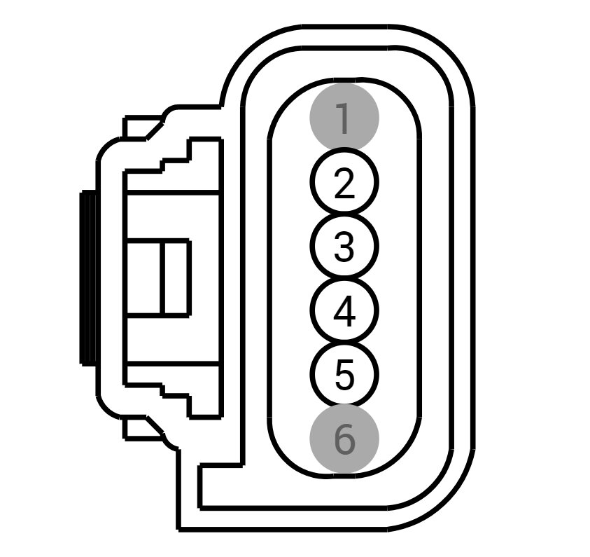

I bought the truck for my dad, and it has a miss in it, he let somebody mess with it, it needs a new pigtail and wired back up, I have everything to do it. The pig tail and wires. all the wires with some color I don't know what goes where. Please help.
Apr 21, 2023 at 5:09 AM
  • 55,224 POSTS
Sure, here is the MAF sensor wiring diagrams and connector view ID just match up the colors with the numbers in the connector and you should be all set. Check out the images (below). Please let us know if you need anything else to get the problem fixed.
