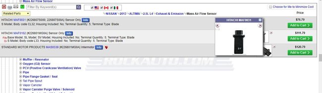

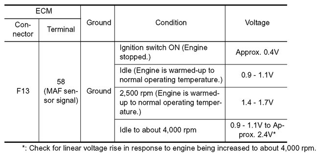

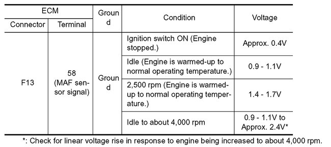

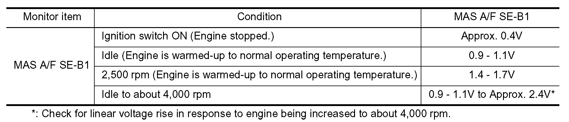

I have replaced my MAF sensor three times in the last seven months, as recently as two weeks ago. Each time it would go about one week before my check engine and slip indicator light would return with a p0101 code and the car would go into “limp” mode which prevents me from accelerating above 2500 rpm and to idle rough. I have replaced the vacuum hose, updated and reset the computer per a Nissan service bulletin, and replaced my air filter in addition to replacing with a stock MAF sensor. Any idea why this maybe a continuing issue?

A mass air flow sensor does not have a vacuum line. Can you post a picture of the sensor you have?

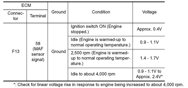

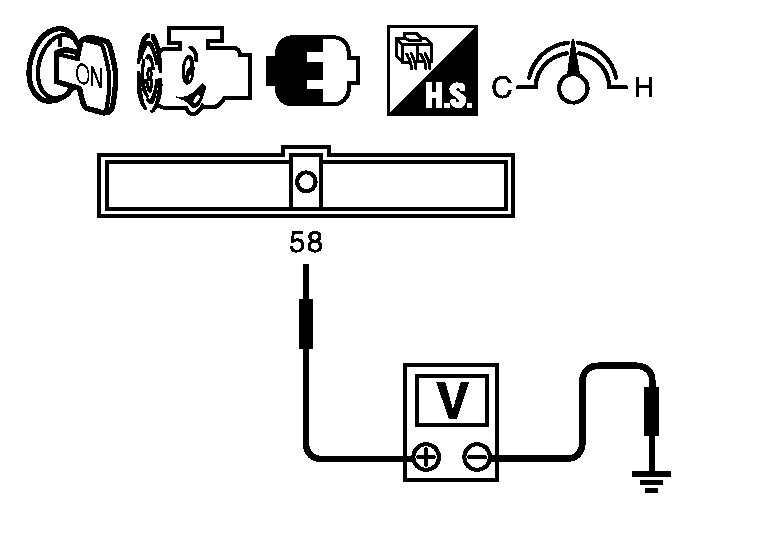

4. With a DVOM at terminal 58 (MAF signal) of the ECM, check the voltage values at the given conditions in the following table.
If any of the above testing is not within specifications, replace the MAF sensor, clear codes and recheck.

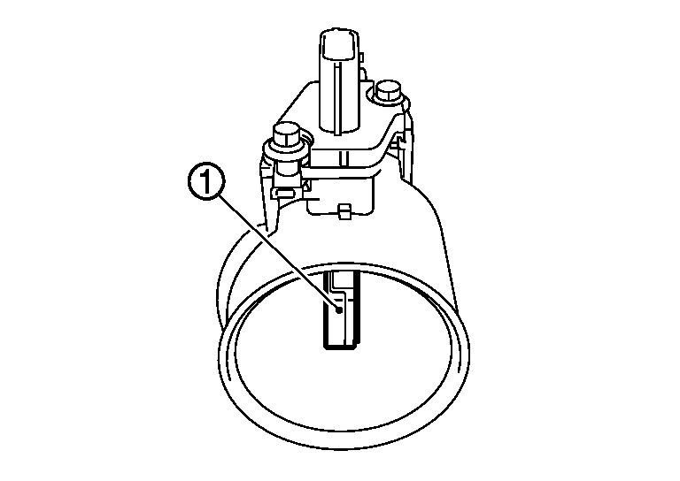

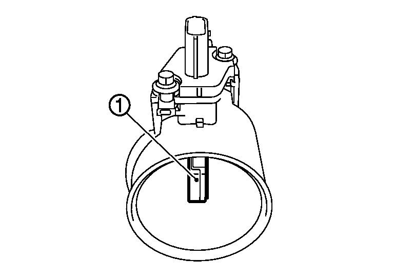

Description
Pic 1
The mass air flow sensor (1) is placed in the stream of intake air. It measures the intake flow rate by measuring a part of the entire intake flow. The mass air flow sensor controls the temperature of the hot wire to a certain amount. The heat generated by the hot wire is reduced as the intake air flows around it. The more air, the greater the heat loss.
Therefore, the electric current supplied to hot wire is changed to maintain the temperature of the hot wire as air flow increases. The ECM detects the air flow by means of this current change.

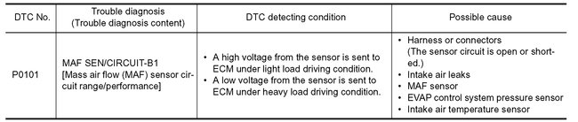

DTC Logic
DTC DETECTION LOGIC
NOTE:
If DTC P0101 is displayed with other DTC, first perform the trouble diagnosis for other DTC.
Pic 2

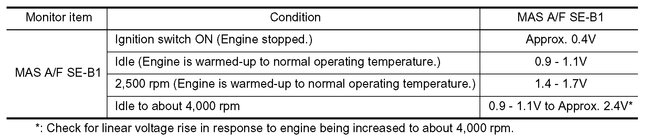

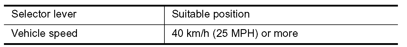

2. PERFORM DTC CONFIRMATION PROCEDURE
1.Start engine and warm it up to normal operating temperature.
2.Drive the vehicle for at least 5 seconds under the following conditions:
CAUTION:
Always drive vehicle at safe speed.
Pic 3
NOTE:
- The gear must be fixed while driving the vehicle.
- Keep the accelerator pedal as steady as possible during cruising.
3.Check 1st trip DTC.

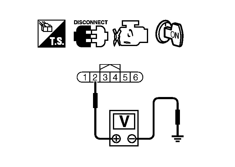

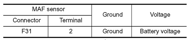

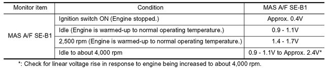

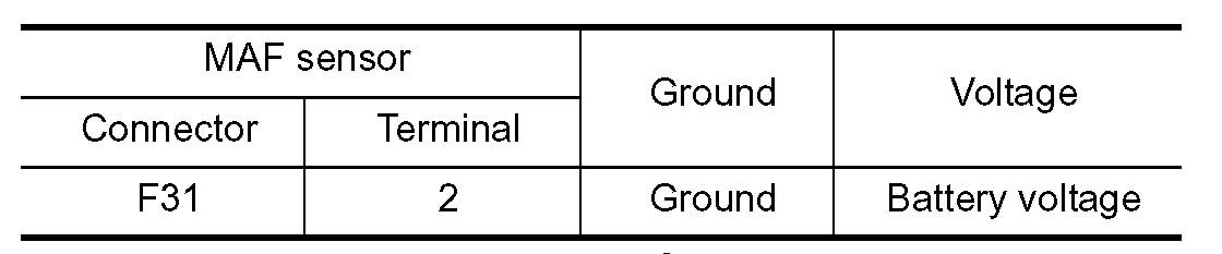

3. CHECK MAF SENSOR POWER SUPPLY CIRCUIT
1.Disconnect mass air flow (MAF) sensor harness connector.
2.Turn ignition switch ON.
Pic 4
3.Check the voltage between MAF sensor harness connector and ground.
Pic 5
Is the inspection result normal?
YES- GO TO 5.
NO- GO TO 4.

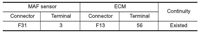

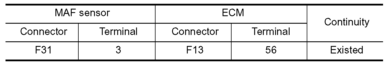

5. CHECK MAF SENSOR GROUND CIRCUIT FOR OPEN AND SHORT
1.Turn ignition switch OFF.
2.Disconnect ECM harness connector.
3.Check the continuity between MAF sensor harness connector and ECM harness connector.
Pic 6
4.Also check harness for short to ground and short to power.
YES- GO TO 6.
NO- Repair open circuit or short to ground or short to power in harness or connectors.

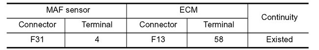

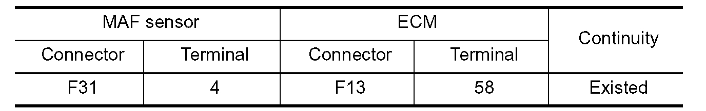

6. CHECK MAF SENSOR INPUT SIGNAL CIRCUIT FOR OPEN AND SHORT
1.Check the continuity between MAF sensor harness connector and ECM harness connector.
Pic 7
2.Also check harness for short to ground and short to power.
YES- GO TO 7.

Component Inspection
1. CHECK MASS AIR FLOW SENSOR-I
With CONSULT
2.Reconnect all harness connectors disconnected.
3.Start engine and warm it up to normal operating temperature.
4.Connect CONSULT and select "DATA MONITOR" mode.
5.Select "MAS A/F SE-B1" and check indication.
pic 8

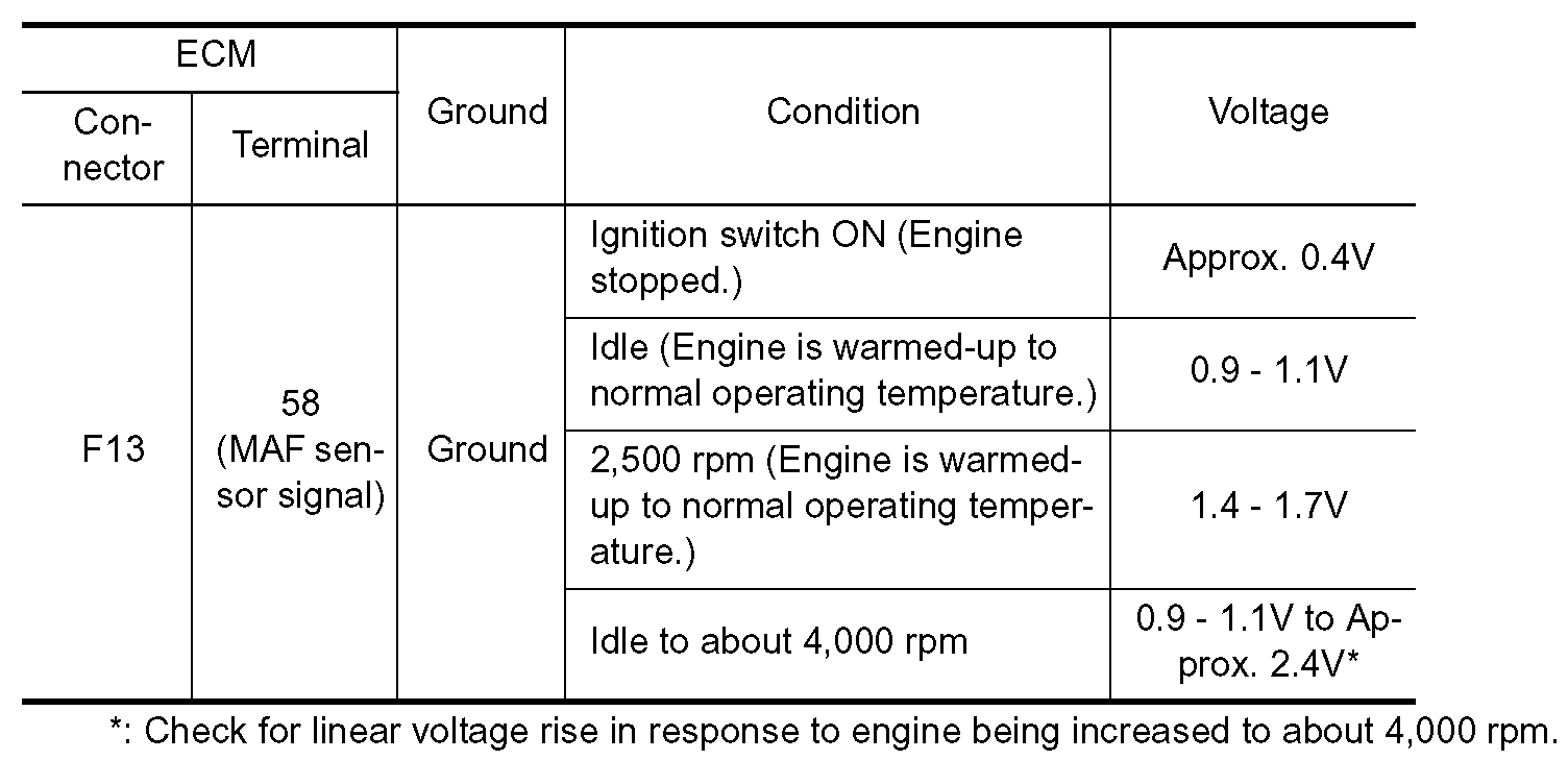

Without CONSULT
pic 9
4.Check the voltage between ECM harness connector and ground.
pic 10

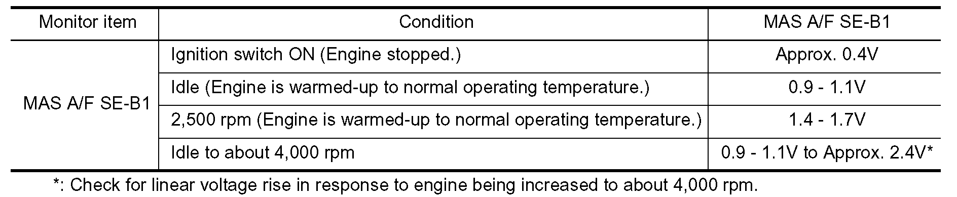

3. CHECK MASS AIR FLOW SENSOR-II
With CONSULT
1.Repair or replace malfunctioning part.
2.Start engine and warm it up to normal operating temperature.
3.Connect CONSULT and select "DATA MONITOR" mode.
4.Select "MAS A/F SE-B1" and check indication.
pic 11
Without CONSULT
pic 12
3.Check the voltage between ECM harness connector and ground.
pic 13
