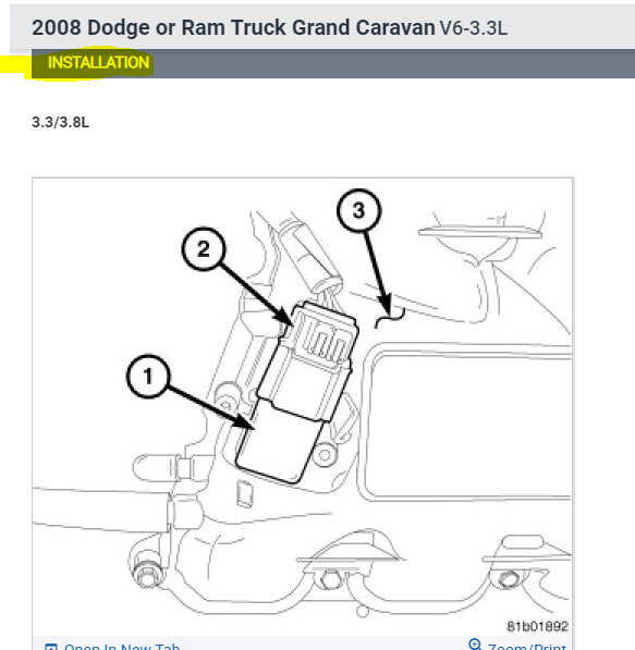

I watched this YouTube video of yours. About 1:10 into the video you show what the mass air flow sensor is. I believe mine is bad but can't find the part anywhere? Can you help?
Mar 6, 2023 at 1:15 PM
  • 110,240 POSTS

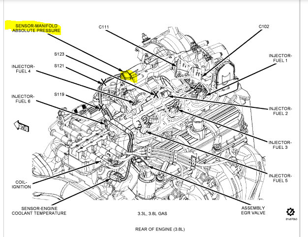

On your vehicle, there is no mass air flow sensor (MAF). In its place is a manifold absolute pressure sensor (MAP). If you look at pic 1 below, it shows a general location.

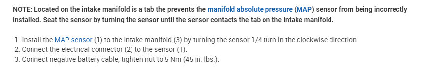

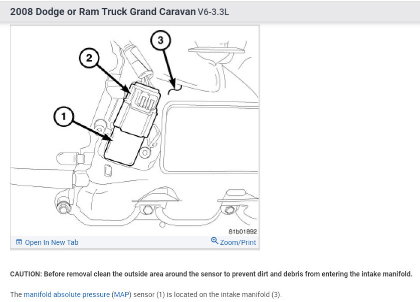

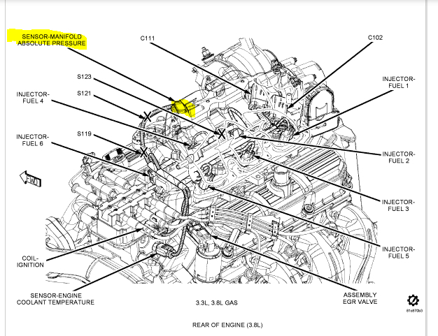

The remaining pictures are the directions for the removal and replacement of the MAP.
