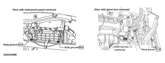

The first part is easy. We are just inspecting the intake system,
First, check air intake tube between air filter housing and intake. Make sure nothing is obstructing the tube. Also, check to make sure there are no vacuum hoses off, damaged, or disconnected.
If all is good, next we need to check grounds. See pic attached and check them to make sure they are clean and tight.
If the grounds are good, next we need to check the MAF sensor power supply. To do this, disconnect the MAF wiring plug and then turn the key on. Check for power at terminal 2 and ground. There should be battery voltage.
This is where I have to stop and wait for your reply so I know what to do next. This may take some time, but we'll get it.
