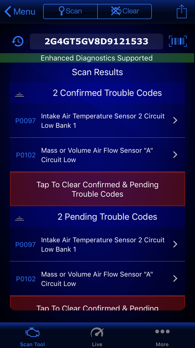

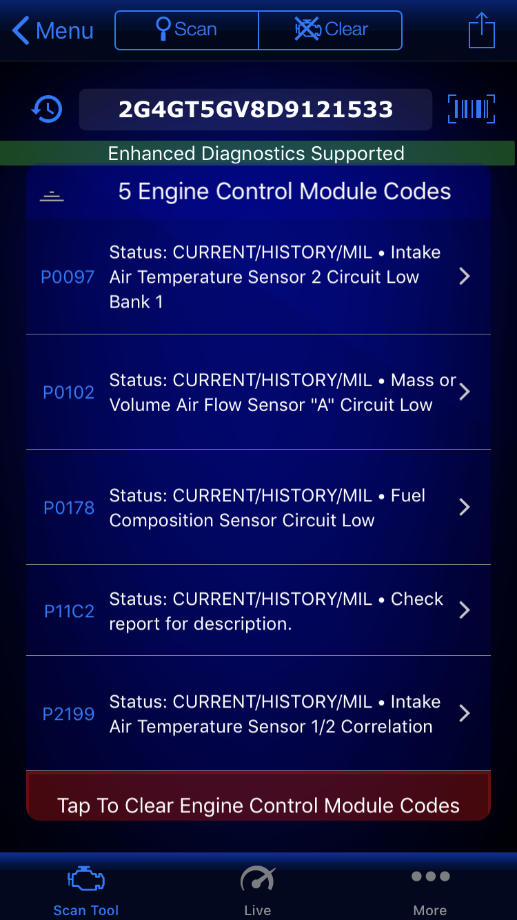

The dealership told me the MAF circuit is the root of all the codes I am seeing on the scanner (photo of all codes attached); however, maybe it’s bigger than that?

Hey MRSHARP86,
What codes do you have stored?

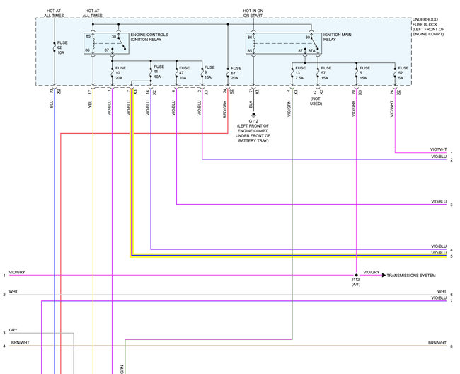

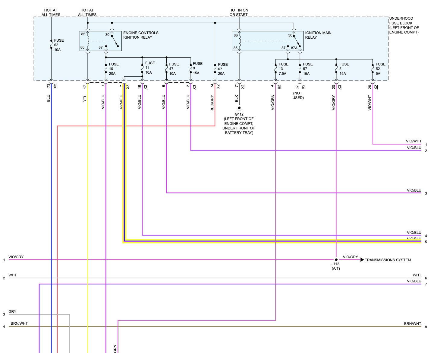

First thing to do would be to check the fuse for the MAF.
This does also supply the fuel composition sensor if fitted so you would have a code for that if applicable.
Fuse 11 in under hood fuse box, 10 amp.

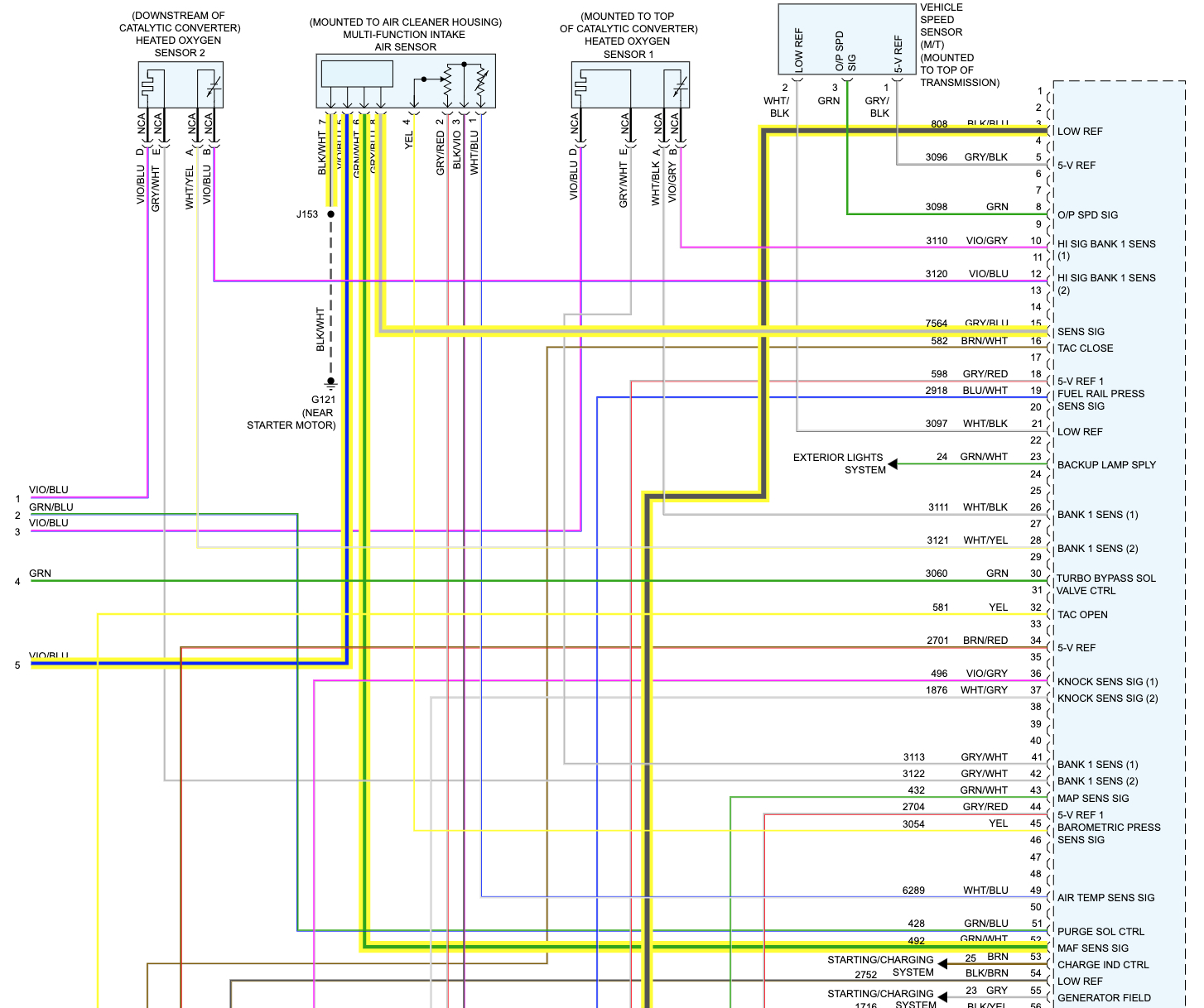

I have attached the wiring diagrams for the associated circuits with the wires for the MAF highlighted.
Hope that helps, let me know how it goes.

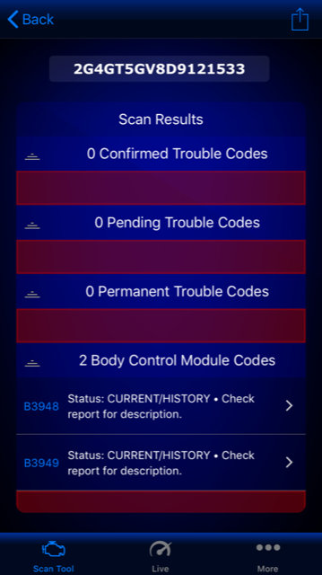

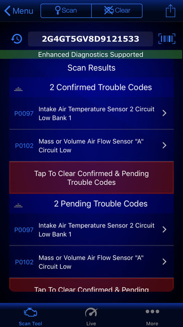

Since I had the battery unhooked for thirty or so hours, all the codes reset; then, when I drove it this morning nothing popped back on. until this afternoon and low and behold, all codes reappeared.

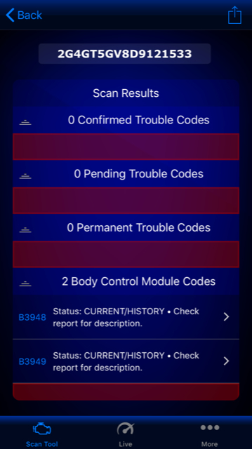

I’ll try the fuse thing today and post back here to let you know. For now, I’ll attach some pictures and an image of what my codes read this afternoon upon them all reappearing.

From the codes it does look like the fuse could be the culprit. Intake air temperature is integrated into the MAF and you did also have a fuel condition sensor issue.
You may then be looking for a reason why the fuse has blown.

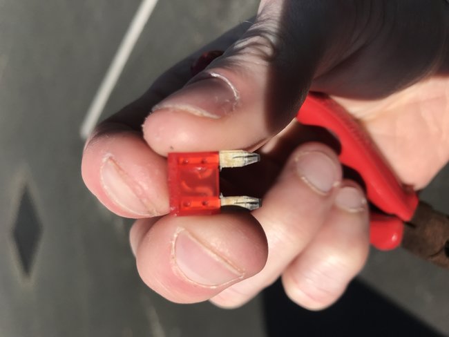

Well Joe, you my friend are an automotive genius! I have to run to get a 10A fuse real quick to confirm, but that sucker looks pretty blown to me. If I pop in the new fuse and it clears everything that’ll do a couple things. 1) Confirm you are awesome at what you do. 2) The Buick dealership I have been to many times have no clue what they’re doing.

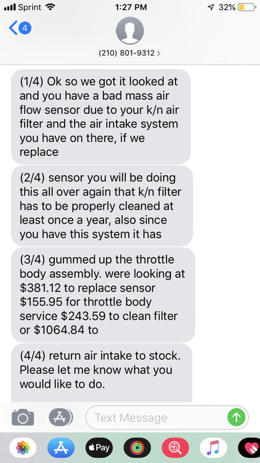

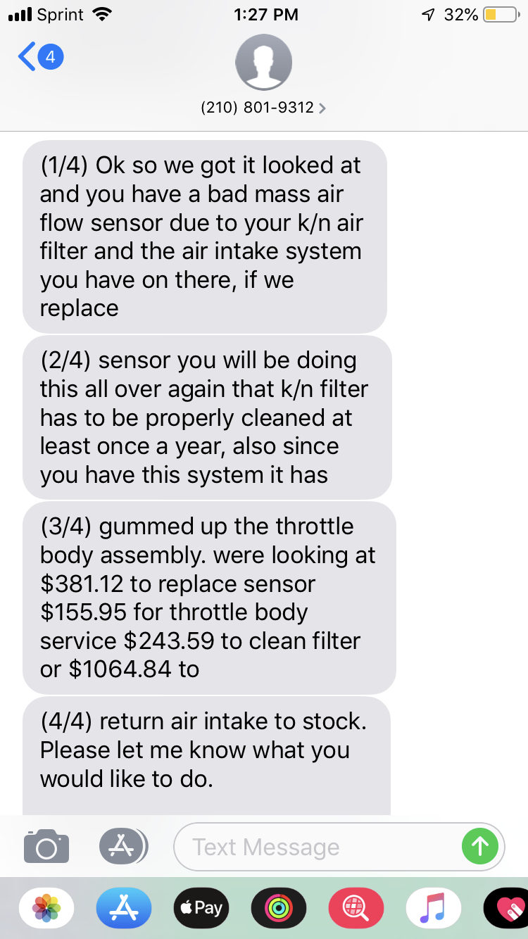

Well Joe, I can confirm you pinpointed the issue, I replaced the fuse, and the car's CEL light went off on the next drive! I am so glad I didn't let the dealership do any of the work they suggested (I'll post a photo of the text I received from the service adviser there showing what they said they found during their "diagnostic"). I paid $160.00 for that diagnostic to only get either lied to or complete ignorance!
Bottom line, you found the issue with ease by looking at the codes, and even pointed me to the exact fuse with the diagram causing the issue. thus, from now on, I'll be coming on this site first for sure. Thank you again for your help on this, my car is grateful too!
