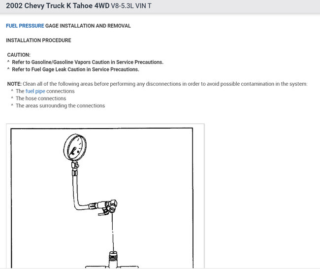

I replaced my mass air flow sensor when I hooked up the airflow sensor the idle changed and it started idling good soon as I put it in Drive and get to around 10 MPH it starts acting like it's being robbed of air.
Sep 9, 2022 at 9:11 AM
  • 55,224 POSTS

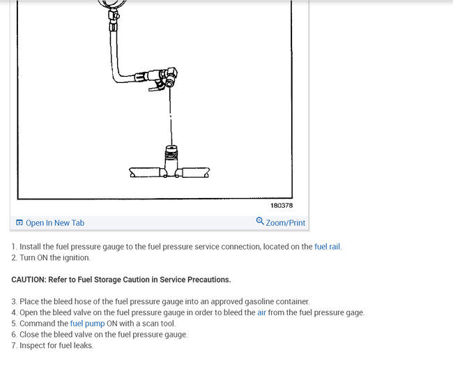

This happens when the fuel pump starts to go out, but to be sure we can do a fuel pump pressure test which you can rent a gauge from the auto parts store for cheap.
Here is a guide that will help and the fuel pump specs as well:
Measure with the Key On Engine Off with the fuel pump commanded On.
Vin (V,T,U)
Fuel Pressure (gasoline) .................... 55-62 psi
Vin (Z)
Fuel Pressure (ethanol) .................... 48-54 psi
Check out the images (below). Please let us know what you find. We are interested to see what it is.
