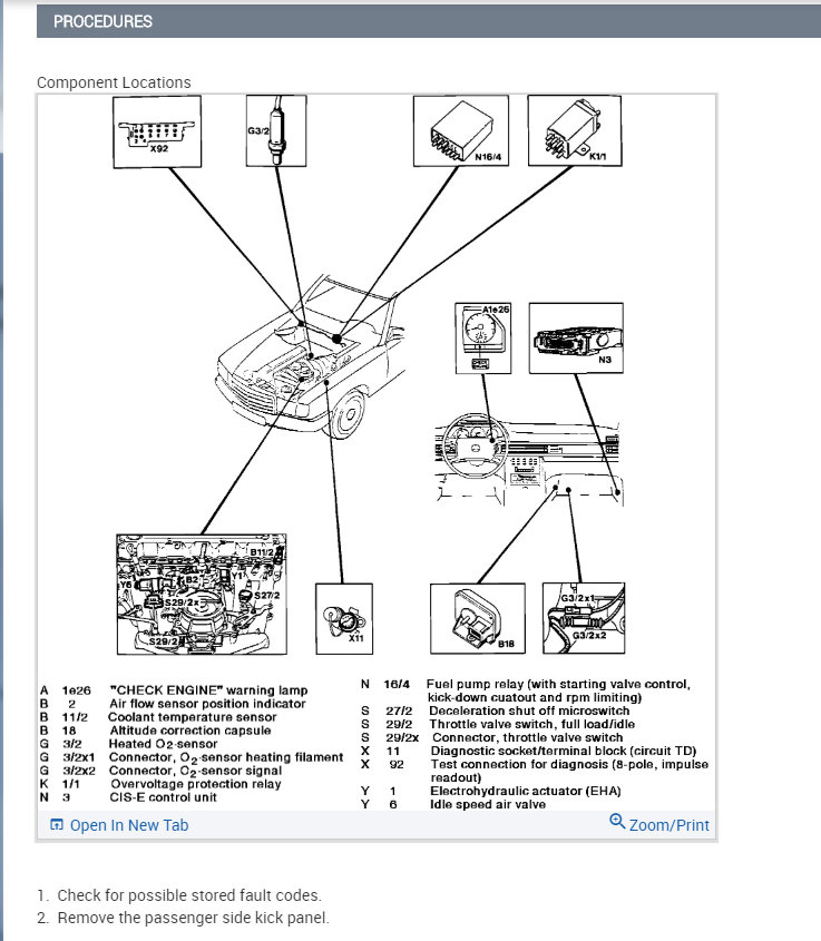

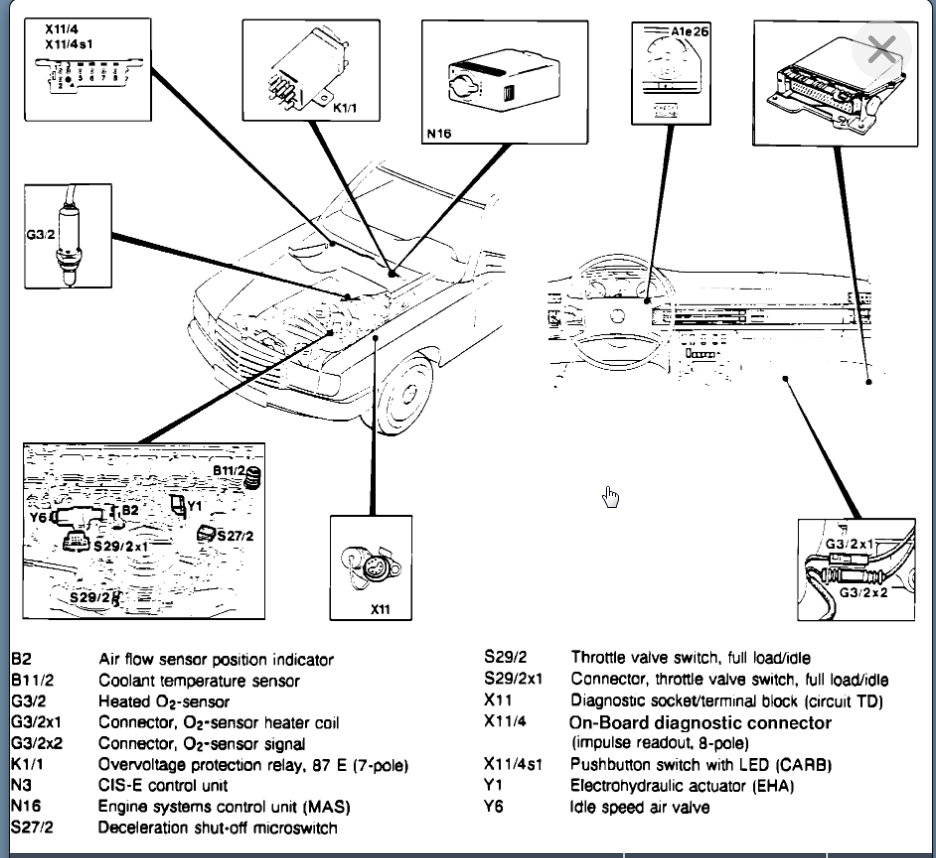

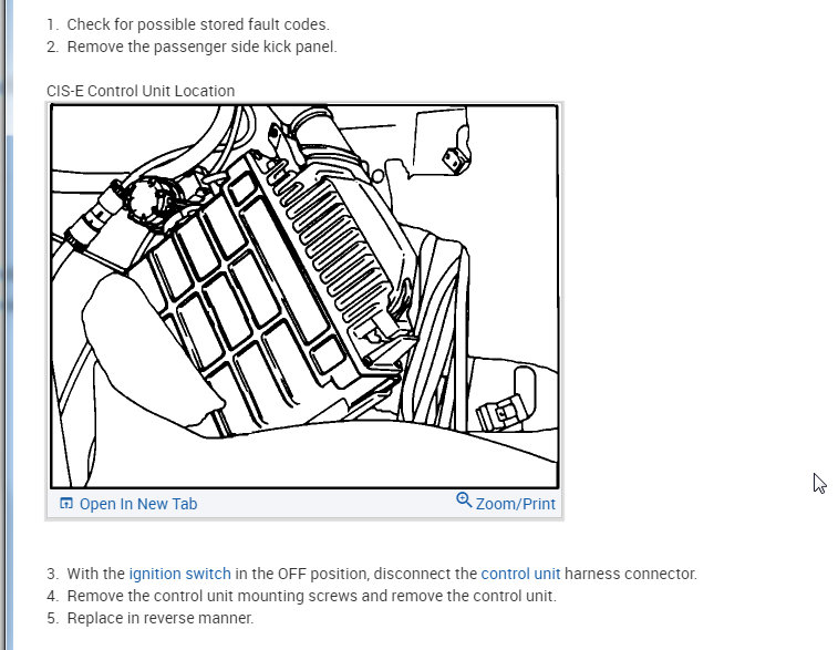

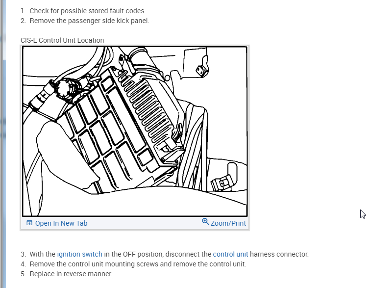

Need to replace the MAS control.

I attached the process for the MAS. Let us know if you need more info. Check out the diagrams (Below). Please let us know if you need anything else to get the problem fixed. Thanks for using 2CarPros.
