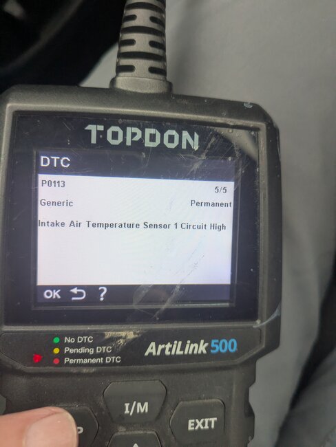

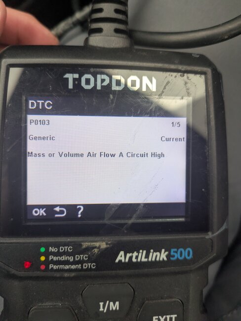

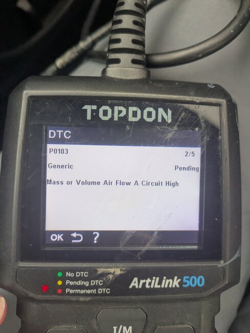

RLPETERSON
  • 5 POSTS
Hi Ken,
The MAF sensor is new, I installed it about a month ago.
I have attached three photos. I have four P0103 and one P0133.
Oct 16, 2025 at 6:42 AM
  • 55,865 POSTS
Yep, all point to the wiring being not correct or you have a shorted out PCM. Also, use a flashlight to see if you can see the small numbers on the connector or sensor, I see the there are two black wires, only one of them (middle #3) should have power when the key is on (12 volts).
