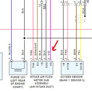

The wiring seems like it is shorting out when wrapped. I would double check your work, here is how the wires should go, also what are the code numbers so I can help fix that problem as well. Here are the wiring diagrams for the MAF sensor so you can make sure it is wiring correctly. Check out the images (below). Please upload pictures or videos in your response.

Hey Ken,
I was waiting to get a sensor plug for my 2013 Toyota Corolla. I received it on Saturday. When I was installing it, I noticed that on the one that install before, the Brown and White wire was in number 3 position and the black in position 2; different from the wiring diagram. I thought maybe that I may have installed it so I wired the way in the wiring diagram that you sent. I started the car and the engine light came on, but this time I am getting a P0103 and a P0133. So is the wires in the diagram you sent wrong?
Roger
Oct 5, 2025 at 7:52 AM
  • 55,402 POSTS
I double checked the wiring diagram and it is correct. Can you upload an image of the wiring and connector so I can see it to be sure? Also, make sure there is not a leak between the MAF sensor and throttle body.

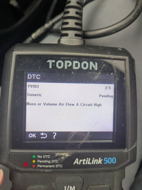

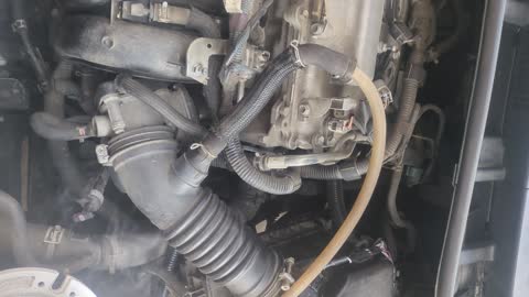

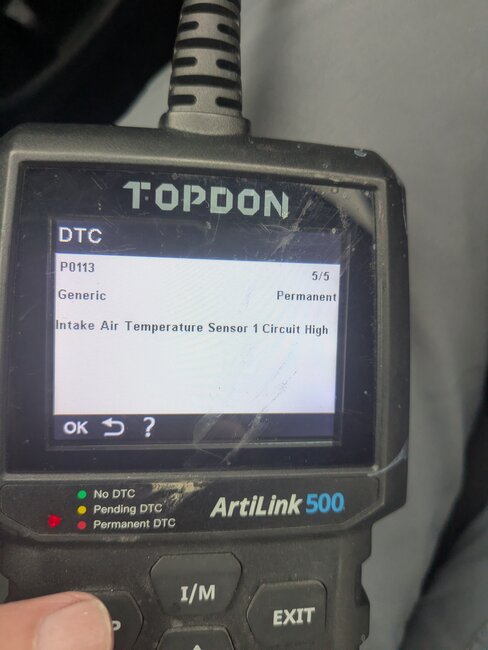

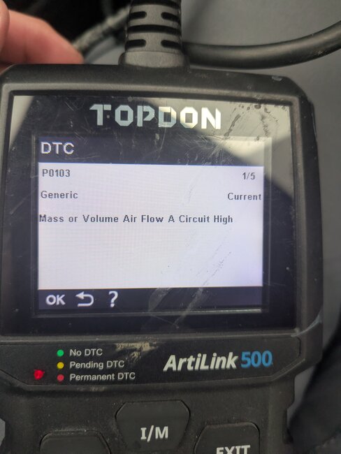

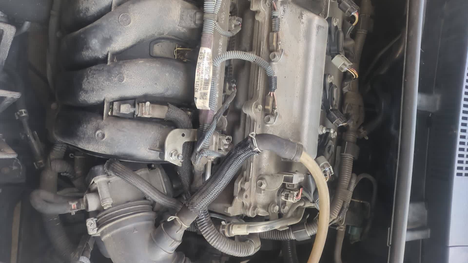

RLPETERSON
  • 5 POSTS
Hi Ken,
The MAF sensor is new, I installed it about a month ago.
I have attached three photos. I have four P0103 and one P0133.
Oct 16, 2025 at 6:42 AM
  • 55,402 POSTS
Yep, all point to the wiring being not correct or you have a shorted out PCM. Also, use a flashlight to see if you can see the small numbers on the connector or sensor, I see the there are two black wires, only one of them (middle #3) should have power when the key is on (12 volts).
