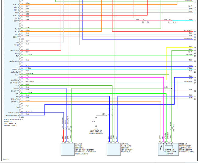

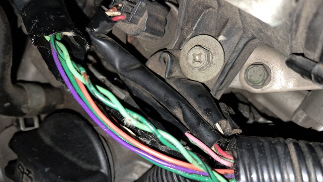

I have a p0100 reading from Bluedriver diagnostic tool. I replaced MAF still have bad code. I realized 1year ago a rat had eaten away at the lt/grn wire leading to MAF. I did check power at the harness and that wire has less volts than the rest. Can this be the issue obd bad code? If so, how to i fix the wire with solder or splice it what type of wire?

Was the wire repaired? if not, this can be the problem. Here is a guide to help test the connections and the MAR sensor wiring diagrams so you can see which wires need to be tested.
P0100 - Mass Air Flow (MAF) Sensor Circuit Malfunction

I would match the wire that you are trying to repair. Do you have an image you can upload?
Mar 14, 2025 at 1:31 AM
VANVERSA
  • 6 POSTS
Hereis the image of the chewed wire. I believe its 18-20. Let me know if the image didn't upload.im going to cut out the bad part and repair it by joining the wire and shrink wrap with solder wire connecter. What do you think?
Mar 14, 2025 at 1:44 AM
  • 55,621 POSTS
Yep, that looks like 18 gauge, you are on the right track to fix the problem, good find btw.
