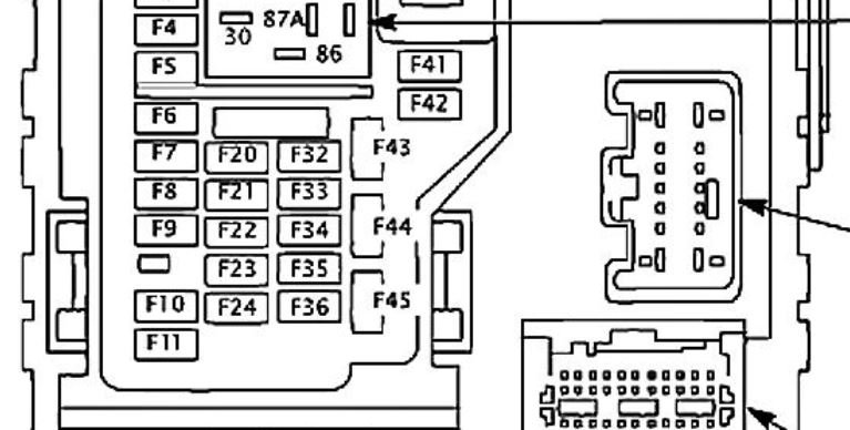

No power to lights, don't know which fuse to check or what else to check.
Apr 24, 2019 at 12:10 PM
  • 110,244 POSTS
Welcome to 2CarPros.

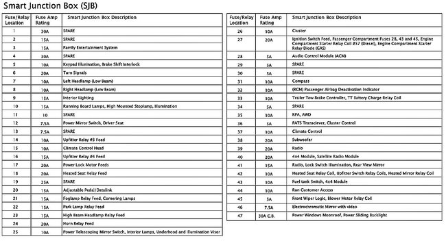

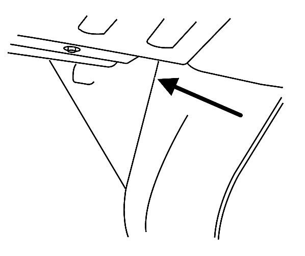

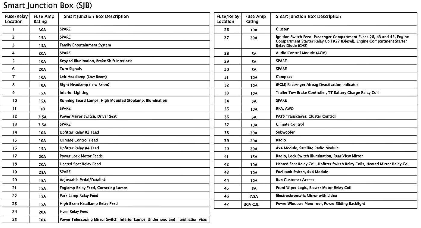

The fuse is located in what is called the smart junction box (SJB). It is located on the passenger side foot well. I attached three pics. The first shows location, the second is a close up of fuse 22 which powers the parking lamp relay. The third picture is a legend of the fuses located in the box. The wiring schematic indicates the lighting relay to be in the SJB also, so if the fuse is good, check that.
