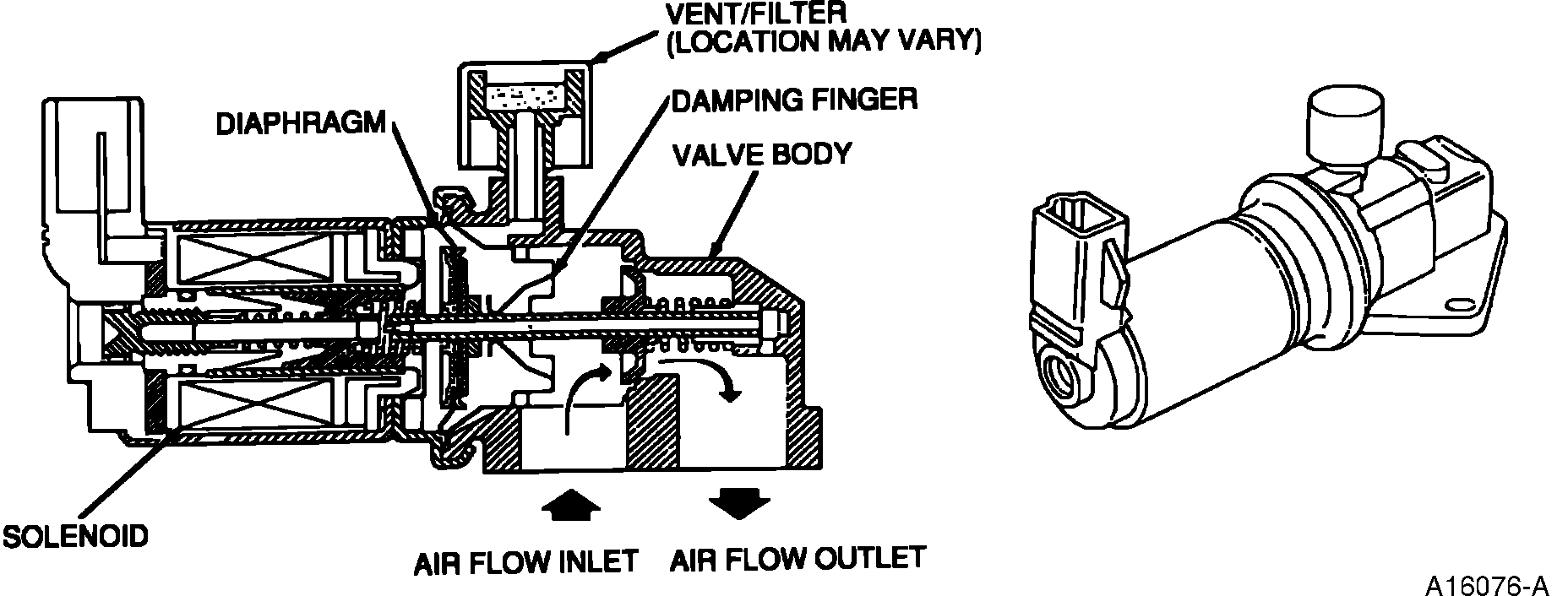

If the idle is below what I suggested, remove the idle air control valve. It is located on the throttle body. Make sure there is no excessive carbon in the valve or where it mounts into the throttle body. Note: The engine idle speed is controlled by the valve, which receives a signal from the power control module (PCM). The idle speed cannot be adjusted.
Also, if the IAC is excessively dirty, it really is not cleanable. It should be replaced. Picture 1 shows what it looks like.
Here are the directions for removing and replacing it.

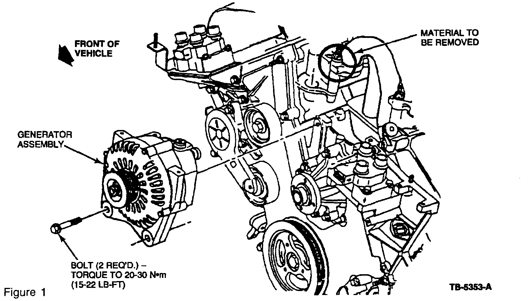

If idle speed isn't a concern, we need to check the belt tension. Also, I remember a technical service bulletin related to alternator replacement. Basically, there is a place on the manifold that will not allow the alt to fully seat. As a result, the alternator doesn't sit flush. It could be causing a tension issue.
After writing that, I looked for the TSB and found it. Take a look at this. Picture 2 shows where it hits.

Replacement generators may interfere with a tab located at the base of the intake manifold and may not fit properly.
ACTION:
Remove the tab to allow proper clearance for the replacement generator. Refer to the following Service Procedure for details.
SERVICE PROCEDURE
1. Remove the defective generator as outlined in the appropriate Mark VIII Service Manual.
2. Locate the tab on the intake manifold casting at the base of the mounting hole boss which is located at the front of the manifold nearest the # 1 cylinder. Refer to Figure 1.
3. Hand file or grind the tab down to the profile of the mounting boss (approximately 5 mm (0.19")).
4. Loosely install the generator and verify there is no interference between the generator and the manifold.
5. Untape the christmas tree clip which is located on the wiring harness just prior to the B+ and regulator attachments.
6. Move the clip 25 mm (1") farther away from the attachments and retape the clip to the mounting point. Tie back any loose wire harness with tie-straps to prevent wire harness chafe or rub through.
7. Reinstall the generator following the procedure outlined in the Service Manual.

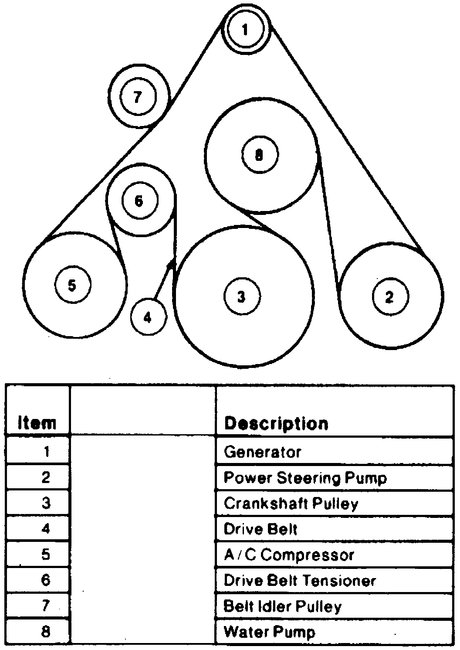

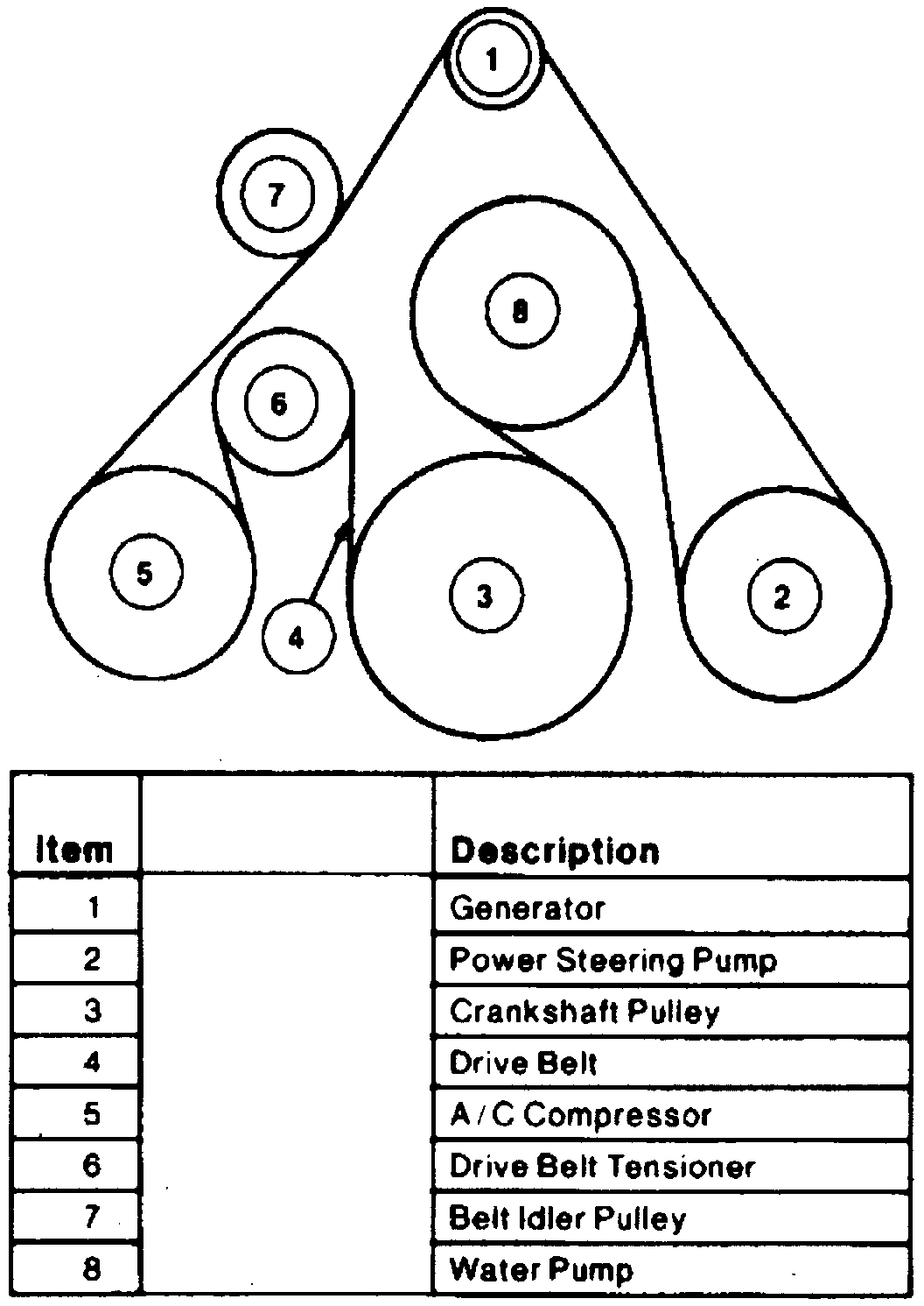

If that is not an issue, I question the belt. I realize they tighten with a self adjuster, but the belt can be worn or the tension-er could be weak. Automatic belt tensioners are spring loaded devices which set and maintain the drive belt tension. Automatic tensioners have belt wear indicator marks. If the indicator mark is not between the indicator lines, the belt is worn or an incorrect belt is installed. Check to make sure the belt is tight and not worn. Also, confirm proper routing. Picture 3 indicates the correct routing for your vehicle.
